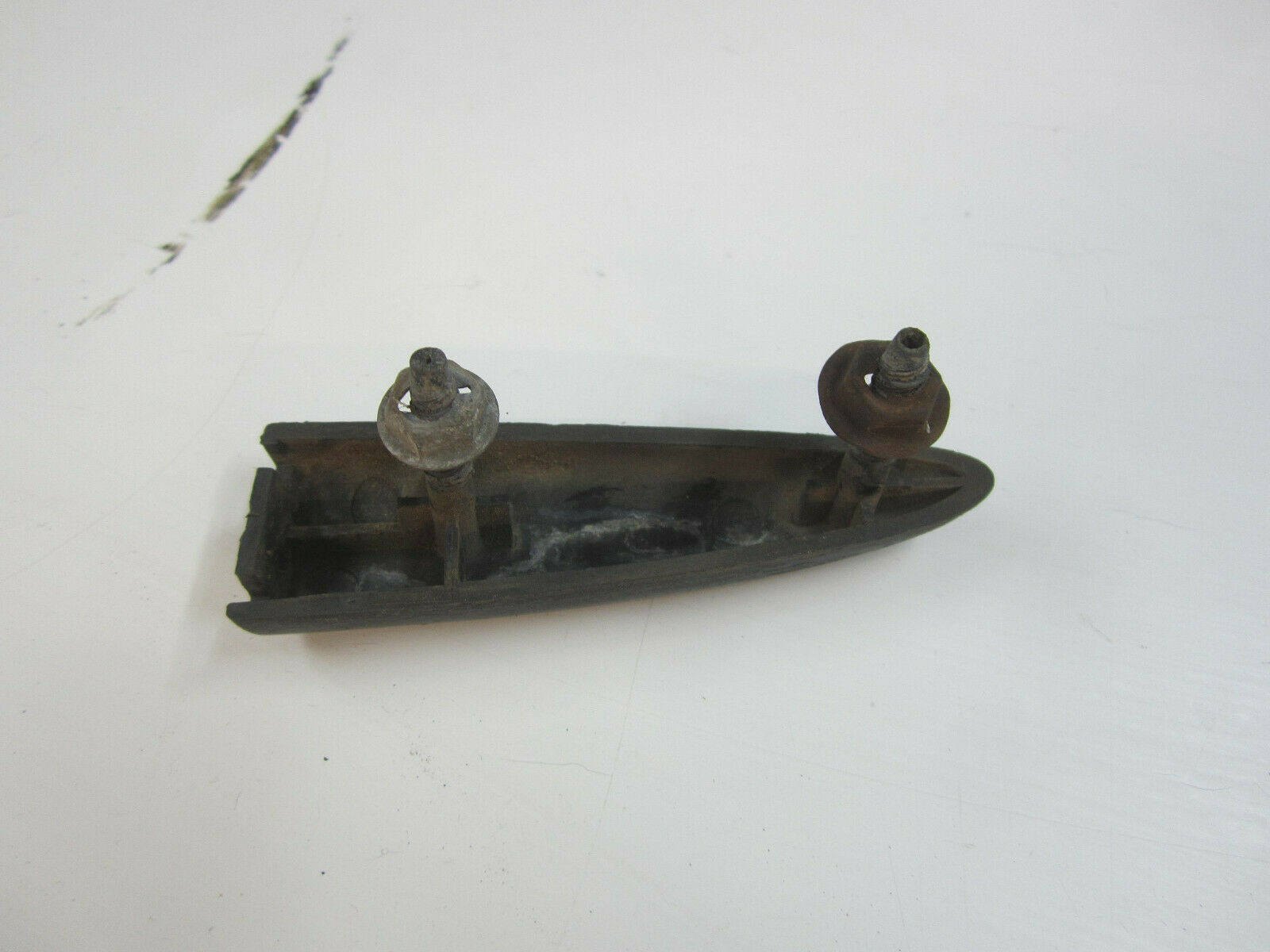

IMSA GT
MAR 23, 09:31 PM
| quote | Originally posted by Mike in Sydney:
Thanks, guys. I may drop the bumper covers anyway to make painting easier. I'll ask the painter what's best. It may be a full, panel-off paint job. I kinda thought that the rear molding was part of the rear bumper cover but I was looking for confirmation. I'm about 80% sure the belt molding in front of the forward side marker lights are separate pieces but I could be wrong. Does anyone know to remove them?
This is how they come off
Mike in Sydney
MAR 23, 11:12 PM
Thanks for the picture. I was guessing a clip or something similar. I would have broken them, for sure. I'll drop the fender liner and get a wrench on it.

fierofool
MAR 24, 08:02 AM
Those things are so very difficult to remove. It requires a 10mm socket and it seems that all 10mm sockets have inexplicably disappeared or been lost.

Frenchrafe
MAR 25, 02:58 AM
Liked the Cowboy poetry!! It's a shame that some people react so stupid in face of a crisis…!? We have had the same types of idiots here organising "family" BBQs, and other taking their rabbits for a walk in order to get out of the house.
For the 10mm sockets, there's no shortage of them here in France.
Good job to repaint your Fiero. I went through the same total strip down when I did mine, and yes the little 10mm nuts really drive you nuts. Especially when they chew up the plastic stem and refuse to come off!!
