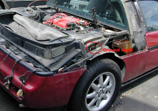

Finally got to working on the car, started replacing bulbs for the side markers. Took a multimeter to the bulb sockets for the side markers and got a 12 v reading on both front side markers, both bulbs light up but don't blink. But I only got a reading of .33 on both rear side markers, and even with new bulbs would not even come on. Where are the rear side markers grounded to? They go into the main harness but I'm not sure where the ground points are at. I'm guessing near the front? Thanks

remove the wheel well liner to see the ground.

Rear markers turn on w/ taillights only and ground as all the rest rear lights.
Ground under rear "fender" is likely good because other side works.
@ sockets, check volts to frame directly then to socket ground. Should be close to same volts. Socket see near 0v then Peirce wire(s) w/ a needle near C500 and test volts to frame there. Coat wires w/ silicon or brake grease to seal out water after.
