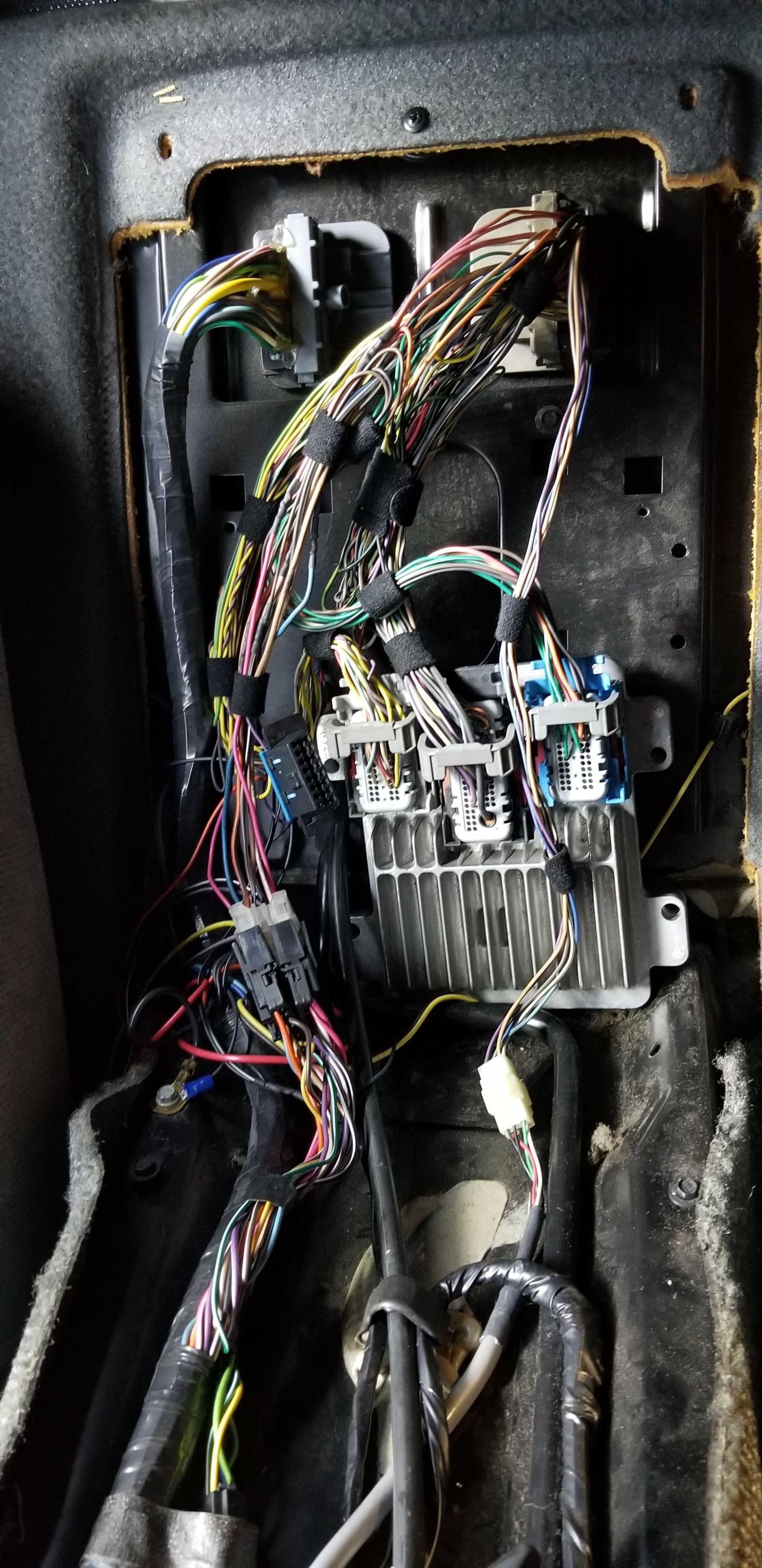

With that said, you must do a full rewrite on these pcm, not a partial. Try that and report back. I can check my tune when I'm home this evening. Also, the PCM connectors are very finicky. Remove each of the 3 connectors and check them with a flashlight. Be SURE all the pins are flush to the face of the connector. Make sure you are using the back caps to the connectors, and make sure the harness is pushed towards the connector, and zip tied in place to the existing strain relief.
Is this the same PCM?
 [This message has been edited by Jncomutt (edited 03-20-2020).]

The ECM looks the same. My problem is that When I do a Write Entire to the ECM with the VATS turned off with HPtuners the engine will start and run normally and all the values look good with the VCM scanner. However when the engine is turned off and you attempt to restart it there are no injector pulses and looking at the injectors with VCM scanned shows all the injectors disabled. When I do another write to the ECM with the VATS turned on the engine runs and when the engine is turned off and you attempt to restart it there are no injector pulses and looking at the injectors with VCM scanned shows all the injectors disabled. I have gone through the DTC's and turned off everything to do with the VATS in both conditions, I just can not figure out why the engine only runs one time?
