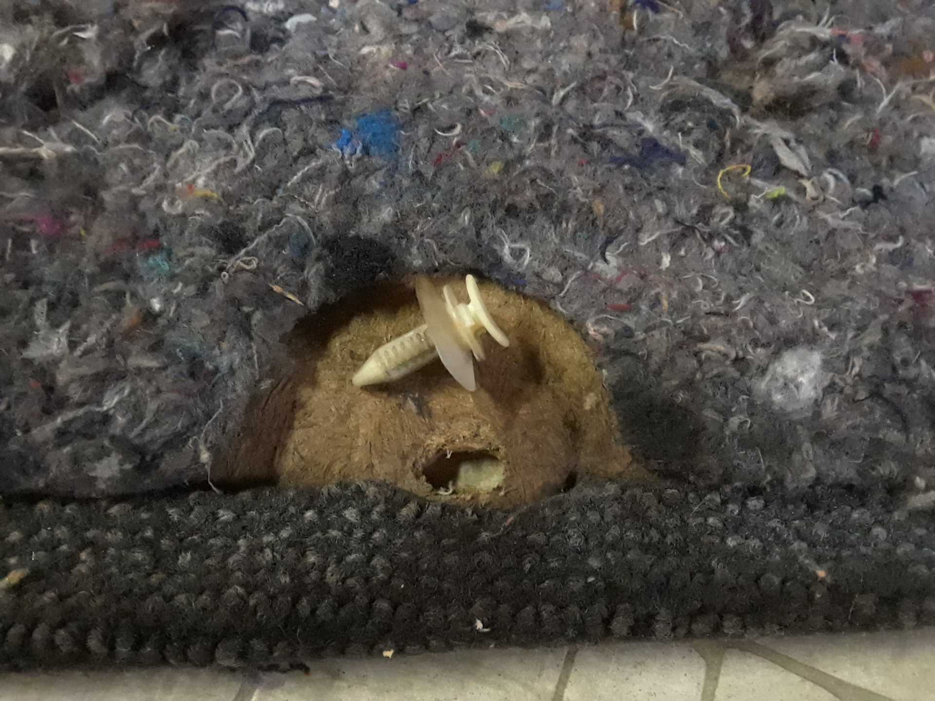

I usually just buy any plastic clip I need from a local auto parts store. As the years go by (10 years rebuilding this car) it seems like all the aftermarket clips are junk and break the next time you try removing them, despite using the right tools.
I'm about to do some interior work and was wondering if anyone could recommend an interior door clip for our cars that they've had good experience with. All suggestions welcome. Thanks.

Note: 1 OE clip is Cut by GM. Is 1 clip that get hit by the window mech. See my Cave, Doors
Maybe dorman has oe ones or something close. Not looking right now. www.dormanproducts.com get thru auto parts stores etc.
Oe ones last for many years but not 30+ years because ozone etc makes them brittle. More so w/ Fiero because outside skin design ve steel skins.------------------ Dr. Ian Malcolm: Yeah, but your scientists were so preoccupied with whether or not they could, they didn't stop to think if they should. (Jurassic Park)

To theogre, that is a good hint about the rear clip, thanks. I think that I read through that page years ago when I replaced the hinges.
I bought the clips from The Fiero Store. They look fine. I'll let you guys know how the next decade goes.
