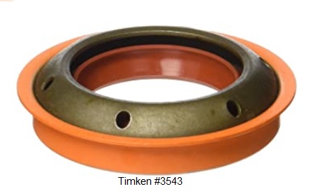

both sides of my 87GT's getrag trans is leaking from the seals, I've found ton's of seals that say "isuzu" but none that claim to be for a getrag....... I really dont want the axle stabilizer bearings due to all thoe horrid storys of them leaking when new. as of right now i'm probably leaking a pint of fluid a week so this is a "must do" type of repair.

Yes. Getrag, isuzu. Muncie, F23, F40... all the same.

Use, Timken #3543 for Getrag

And make sure it looks like this... Color may vary..

GM# 97029260 - Seal:Oil,Drive SH
