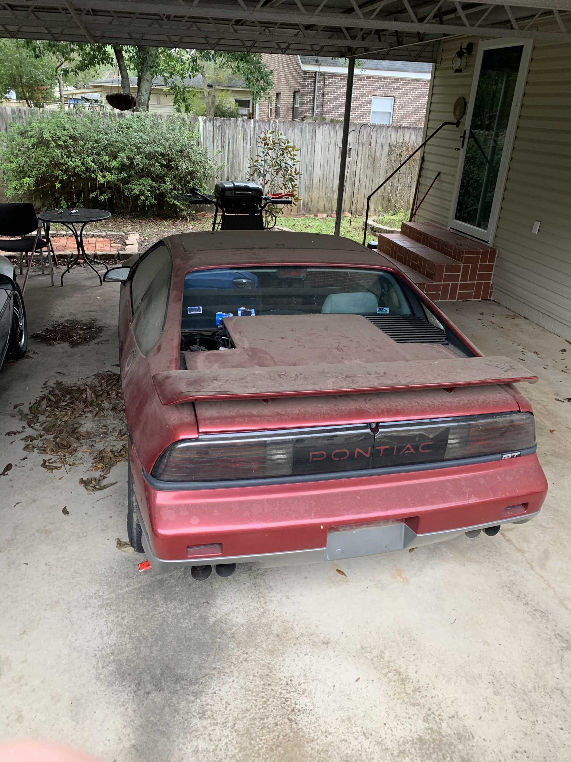

The car has almost no rust, but the paint has clear coat separation and no clear coat at all on the top surfaces. The interior is in good shape for a 32 years old car, and the car is compete with all the original parts and no damage history. The car has only had a few owners, and stayed here locally all its life. The major issue with the 87 GT, was it wasn’t running when I purchased it. It had been sitting for at least two years. Two owners ago, the car developed a “rod knock” and stopped being driven. The car engine was worked on with the oil pan removed and the connecting rod nuts taken off. This owner lost some of the parts and gave up on trying to fix the car, and sold the car.
The next owner, bought all the parts that were missing, but didn’t have the time or energy to fix the poor Fiero. It sat in a carport for almost two years, where I ended up buying the car. I was able to put in a new battery, put the engine back together, and get the thing started. I was just checking to see if the starter would crank and possibly get the engine to turn over, and was shocked when it started right up! The car had been sitting for years, and in less than week, I was able to get the car started. The engine didn’t sound the best, but it idled good and would move under it’s own power. Pretty good for a little effort and time.
Here are some pictures of the car when I first saw it.

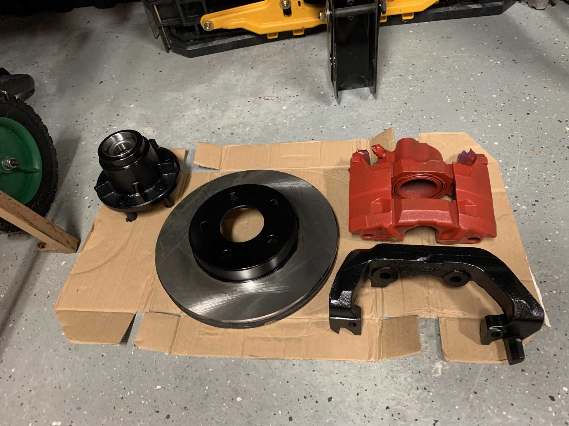

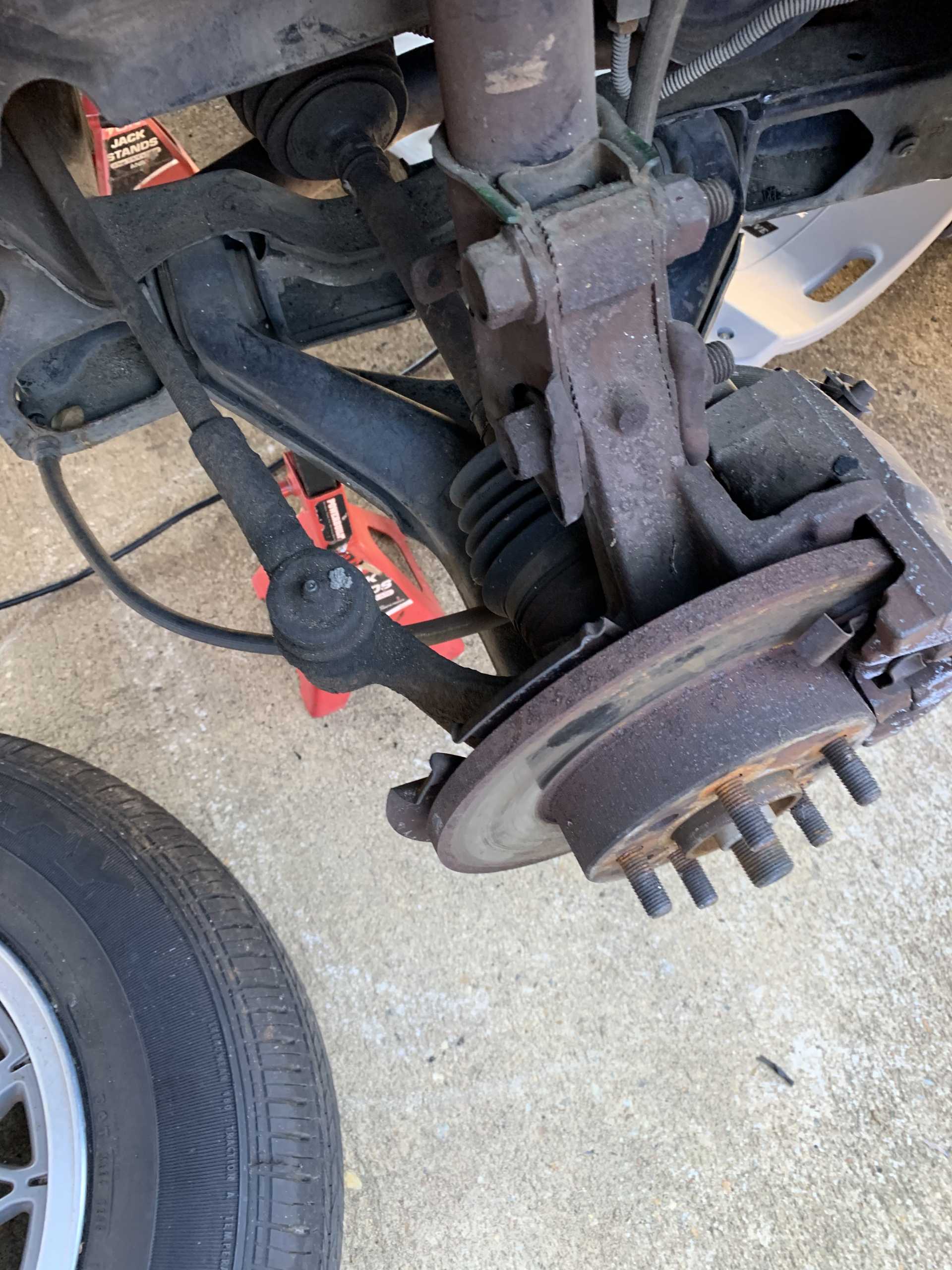

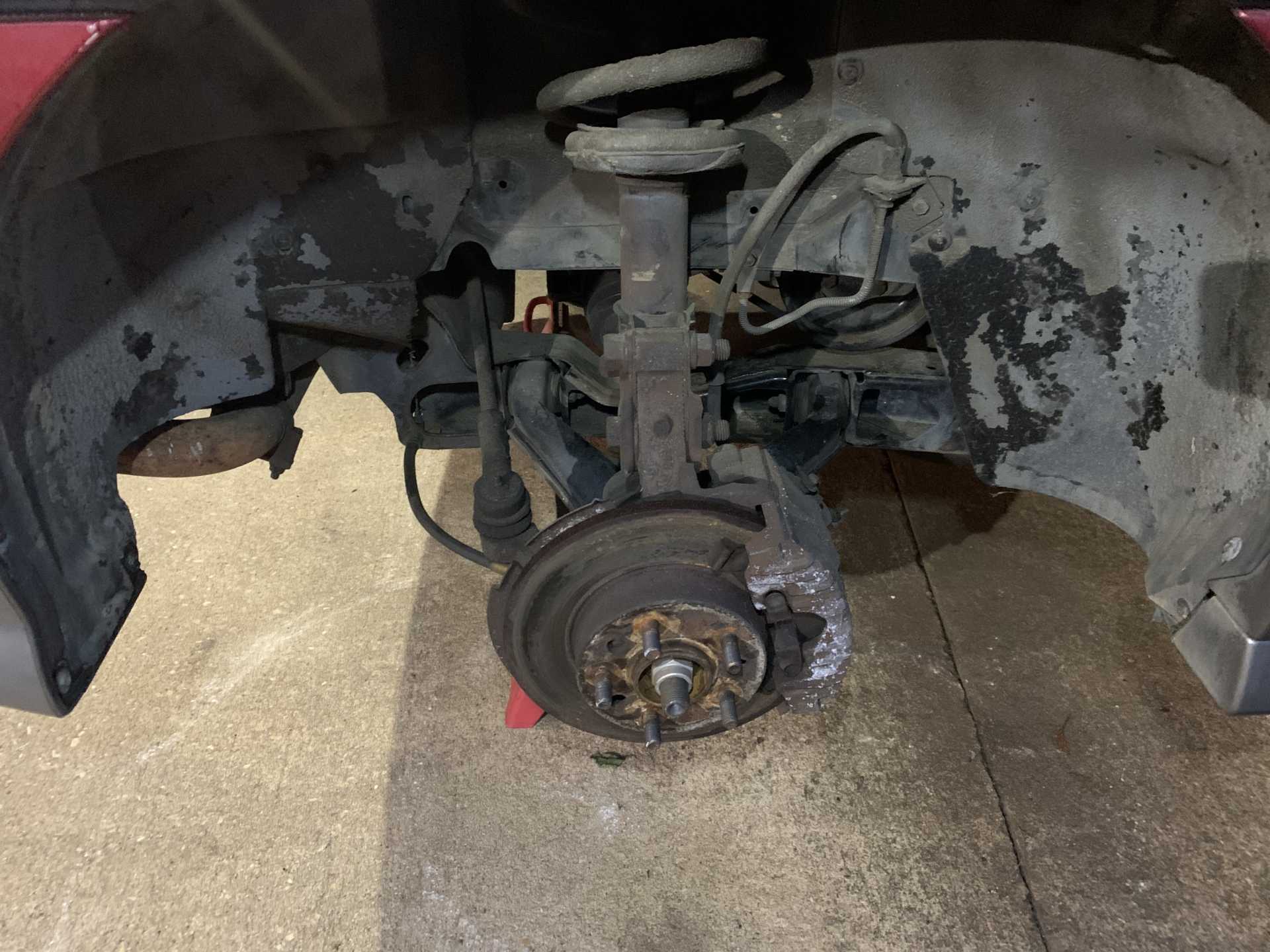

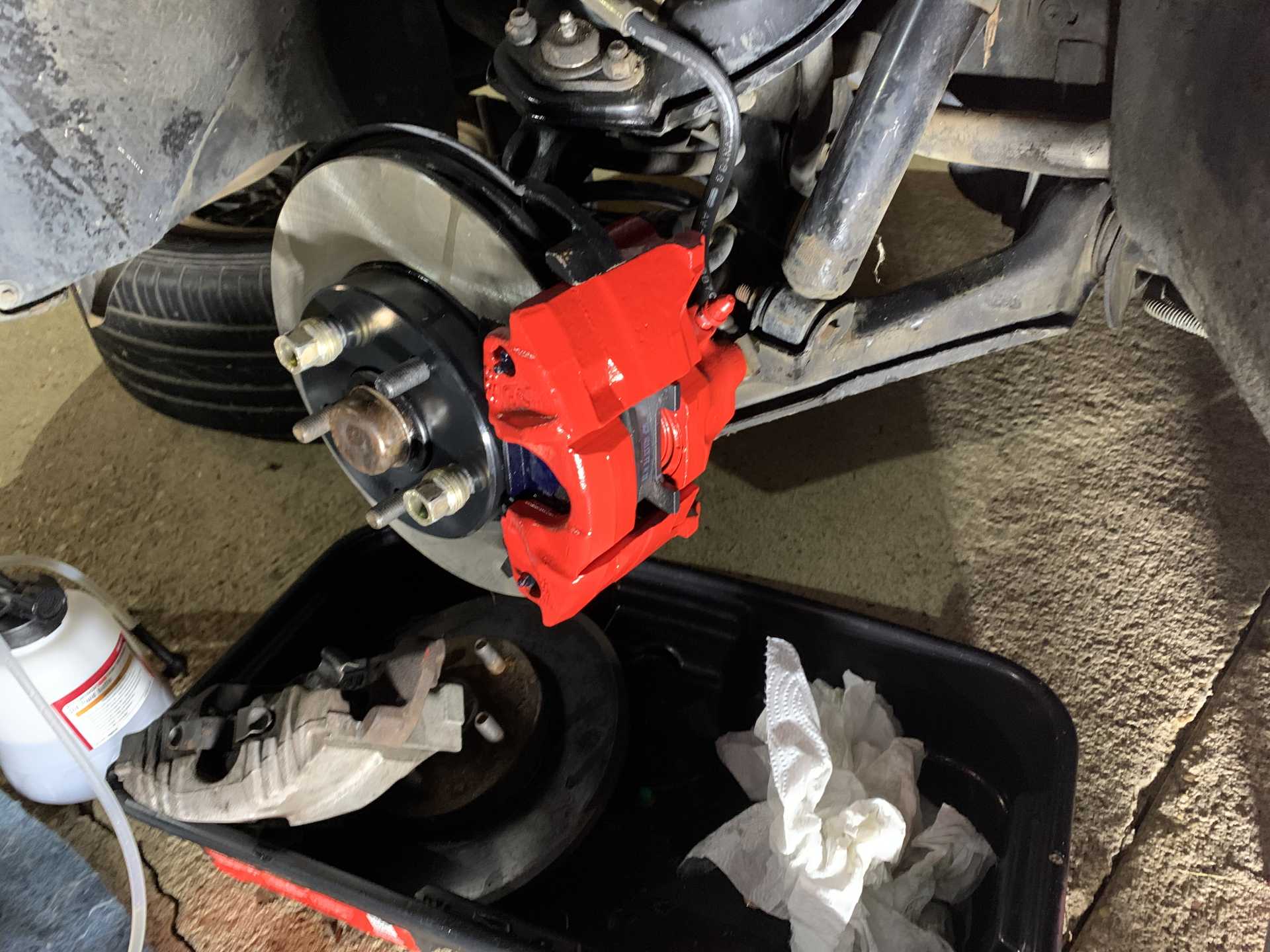

Next, replace and upgrade the rusty, nasty, seized up braking system, and drain, refill, and bleed the lines.
The back brakes are going to be replaced with drilled and slotted rotors, but I will be using remanufactured stock 1987 calipers.
For the front brakes, I am replacing the hubs, rotors, and calipers using the vented brake upgrade kit from the Fiero store:
https://www.fierostore.com/...px?s=56004&d=379&p=1
