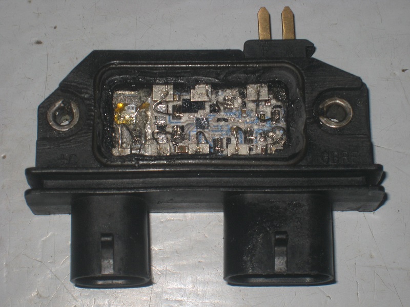

I did a teardown on two ignition modules:
-GM-
- Ceramic PCB, so better heatsinking for the electronics on it
- The wire leads are spot-welded to the terminals
- The cover was very well sealed; I had to Dremel it off
-Wells/WVE-
- PCB looks like normal FR-4, would not be as thermally conductive
- Leads soldered, more chance of the solder melting and breaking the connections
- The cover simply pried off. No confidence in the enclosure's sealing capability.
Comparing the two, the Wells/WVE unit is pure junk, so I'd suggest installing your original GM module, no matter how old it may be!
You could keep the jobber unit as an emergency backup, but I wouldn't count on it working when you need it to...
My previous Fiero would only run with a genuine GM module; it wouldn't even start with the jobber stuff! I don't have any explanation for that.[This message has been edited by pmbrunelle (edited 03-02-2020).]
