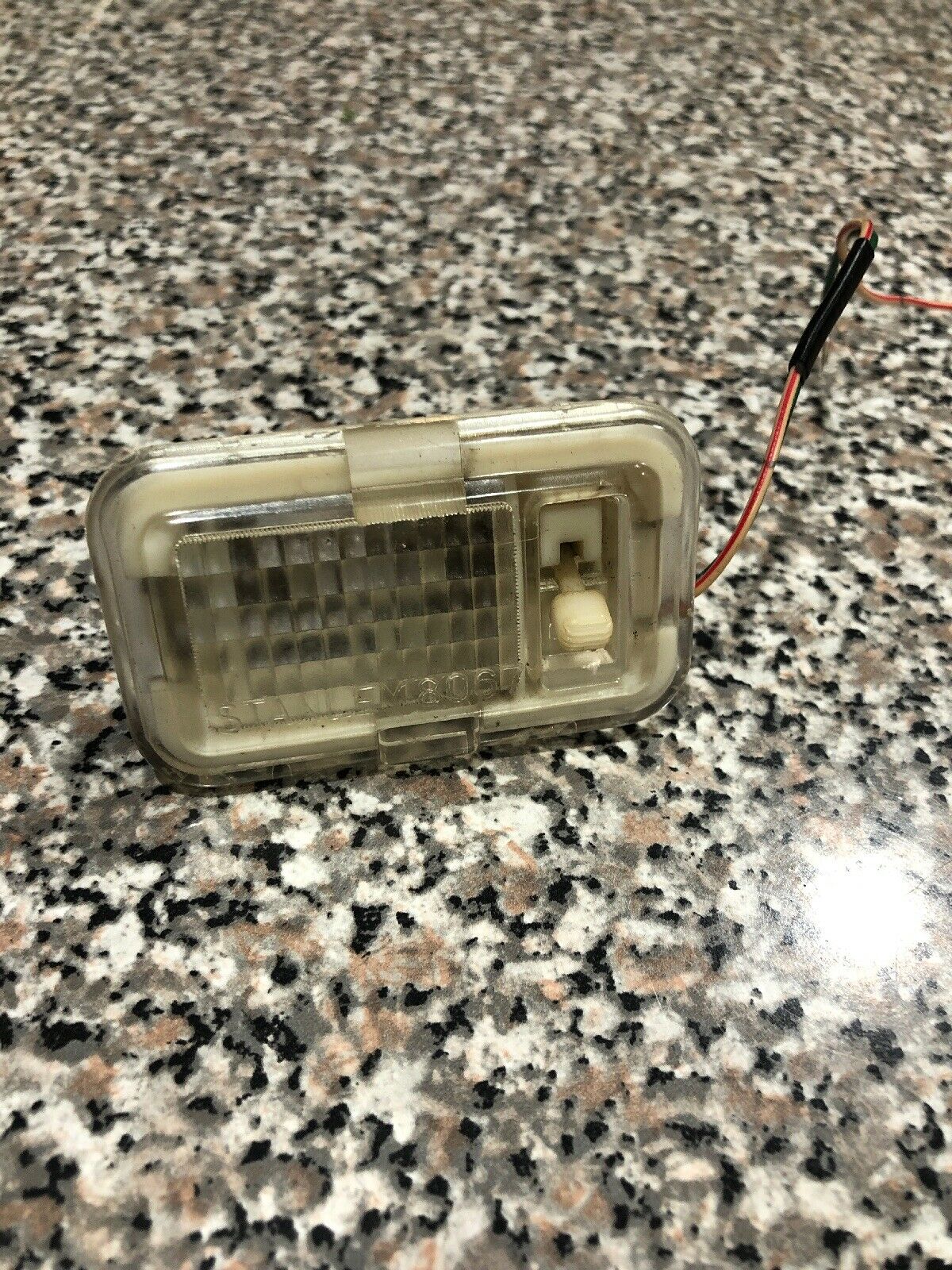

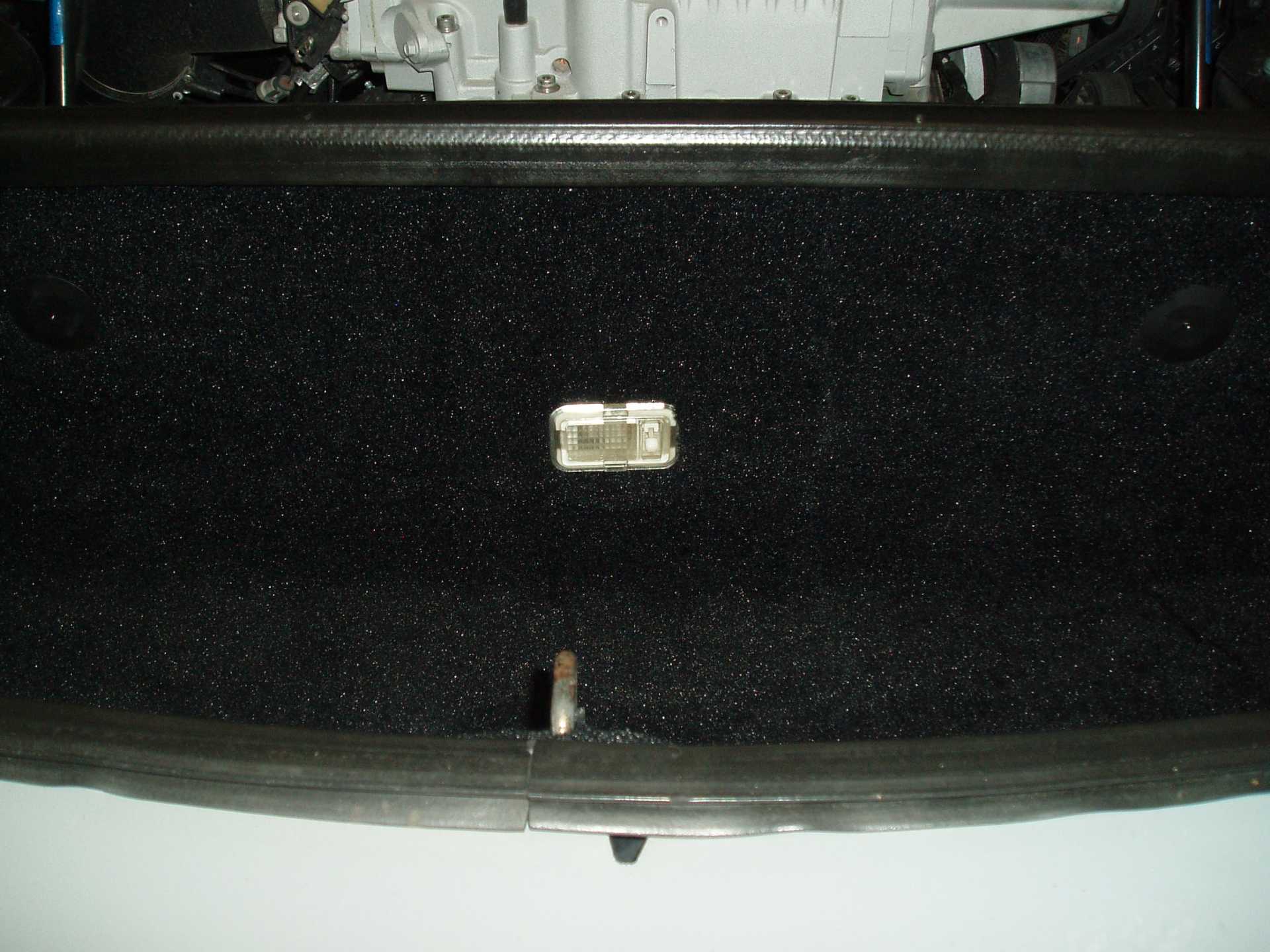

fierosound
MAR 01, 11:58 AM
David Hambleton

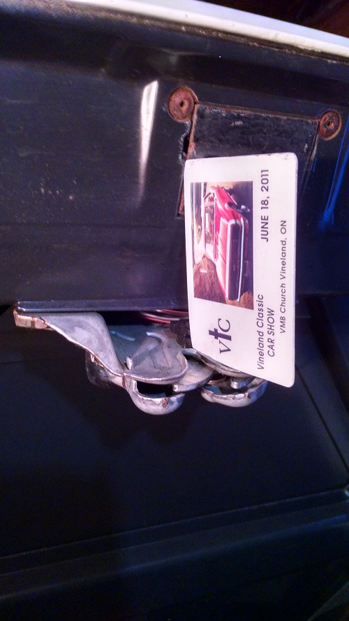

Here's a temporary solution I use instead of installing a switch:
 [This message has been edited by David Hambleton (edited 03-01-2020).]
MAR 01, 07:28 PM
When at a car show I just put a bolt on the lock plate, close it and it keeps the switch turned off. If you want to use the Blazer truck light with the switch the hole that holds the light housing must be enlarged. ------------------ " THE BLACK PARALYZER" -87GT 3800SC Series III engine, custom ZZP /Frozen Boost Intercooler setup, 3.4" Pulley, Northstar TB, LS1 MAF, 3" Spintech/Hedman Exhaust, P-log Manifold, Autolite 104's, MSD wires, Custom CAI, 4T65eHD w. custom axles, Champion Radiator, S10 Brake Booster, HP Tuners VCM Suite. "THE COLUSSUS" 87GT - ALL OUT 3.4L Turbocharged engine, Garrett Hybrid Turbo, MSD ign., modified TH125H " ON THE LOOSE WITHOUT THE JUICE "

Q-tip in the lock at car shows works as well. Ha
I do like that switchable light though. Very nice.
