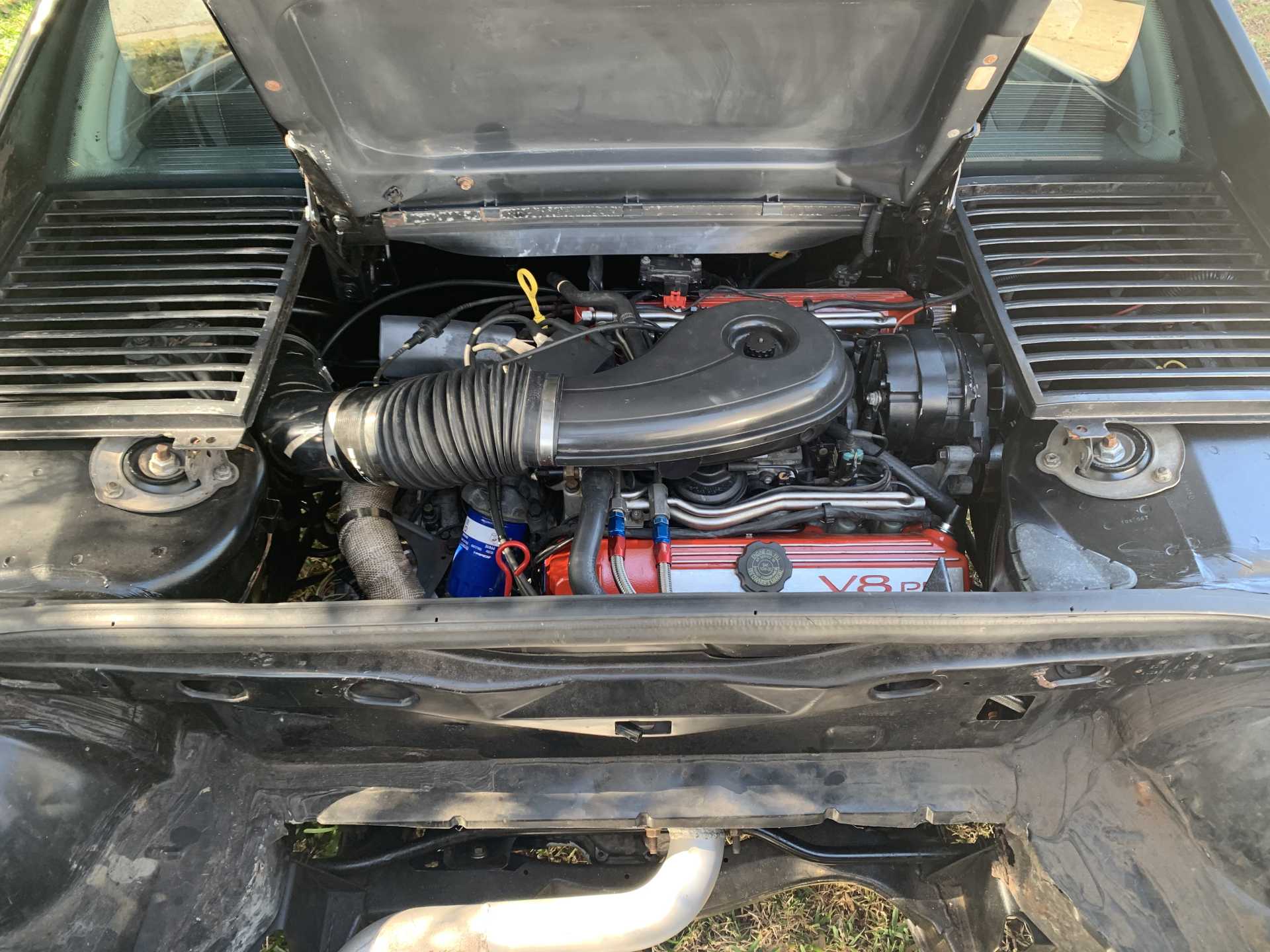

I need help on a 4t60e with a 4.9 swap that is shifting weird. Under full throttle it shifts great. Firm shifts at the right RPM. with no load it doesn't want to up shift. And when I'm cruising, it hunts between gears. The only way to get it to shift up consistently is mash the pedal. I don't know the history of the drive-train. It came in a car unfinished. I just recently got the engine in my formula and driving. It has the Ed Parks/Fiero Factory engine harness. Any help is appreciated.
Edit to add. All 4 shift solenoids and Vacuum modulator have been replaced. Vehicle speed sensor works and is accurate compared to GPS.
