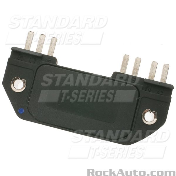

Most likely GM put in a Fiero engine.....but it is GM after all. If the ICM on the engine looks like this, it is an '84.
handymanpat
FEB 23, 11:39 AM
Thanks. I will let him know.
