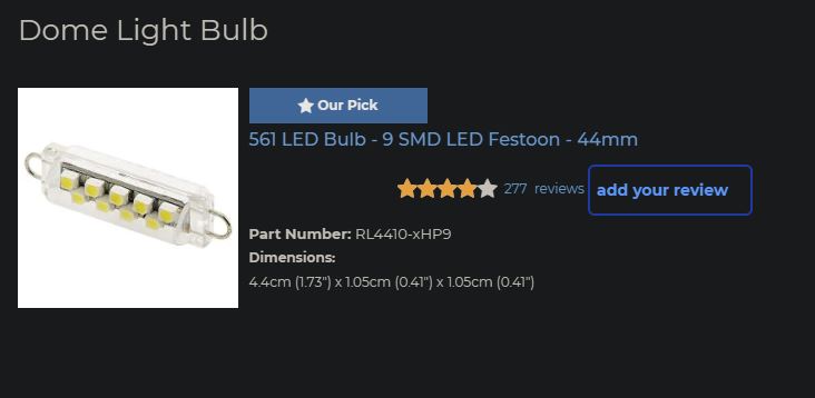

 I just had a dome light button melt on me likely from leaving the bulb on too long. Does anyone know which lights are in the dome/reading lights for LEDs? Orge's cave is listing 561s or 906s.

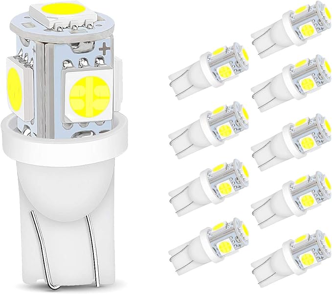

 I see these on Amazon listed as "10x LED Replacements for Malibu Landscape Light 5 Led/SMD Per Bulb 194 T10 T5 Wedge Base Cool White 12v Dc 1407" so they are being listed as T10s  not  T3 or T5.

          | Look up t15 bulb those are the more common name for the type you are looking for, same base as 194/t10, but bigger "bulb" |  |
          |   | Spadesluck | MAY 13,  02:45 PM |  |
          | Whatever you use do not use the ones you referenced. They do not work well in the dome. The light pattern doesn't work well with those. They will work but not to what you are probably wanting. |  |
 Thank you I had a suspicion about this. Do you happen to have any recommendations on what worked for you?
 Thank you everyone!
 Matthew
          |   | Spadesluck | MAY 14,  12:50 AM |  |
          | Find an LED 906 bulb that gives a better pattern. I actually need to replace mine to a better pattern bulb myself. I have the ones that you referenced above. Hence why I am saying get a different bulb. Find a more "round" LED with the diodes that go around in a circular pattern, less blocky. LEDs are only good if the diodes are aimed the right way. |  |
