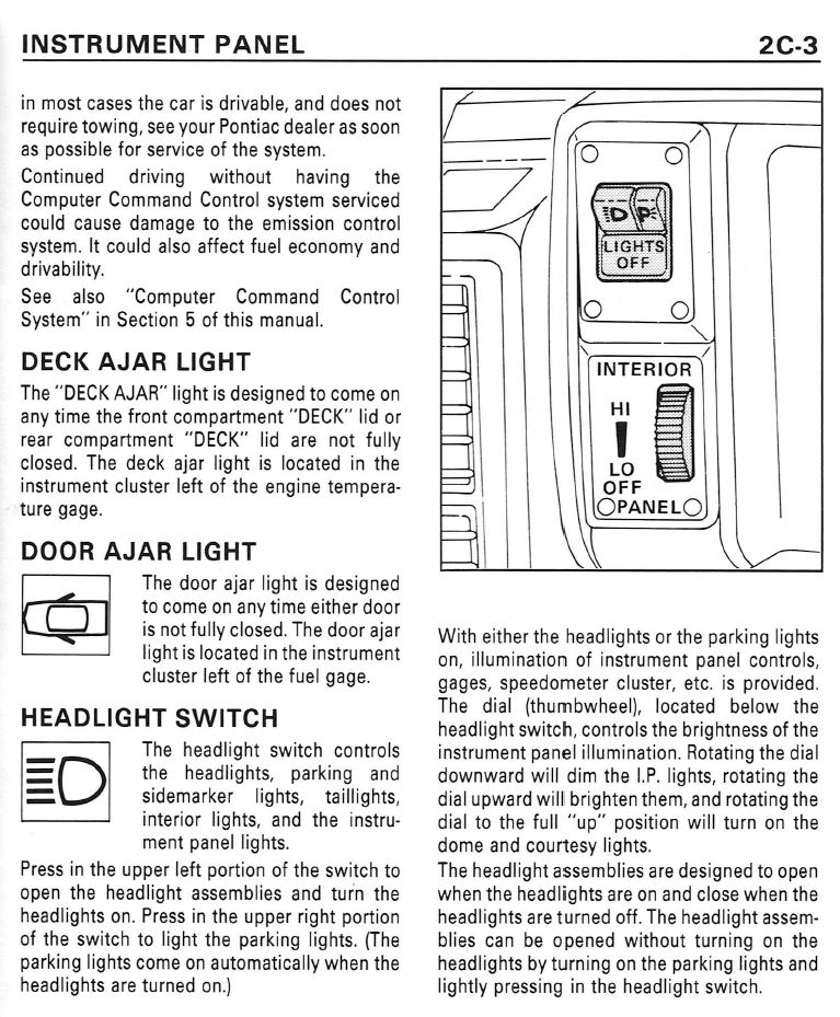

I am in the process of restoring the electrical in a 85 GT. For some reason the dash dimmer switch when fully engaged activates the lights that come on when the door is ajar. I have the dash removed to aid in tracing the wires. Does anyone have any guidance on tracing what is going wrong?

fierosound FEB 17, 05:30 PM
That's how it works.

Would you be able to tell me if the car has to be running for the backlight to work? I attempted to turn on the backlight in the first ignition position with no effect.
olejoedad FEB 17, 06:45 PM
1985 Fieros did not have backlit gages, they were illuminated by reflection.
The headlight switch must be in the parking light or headlight position.
