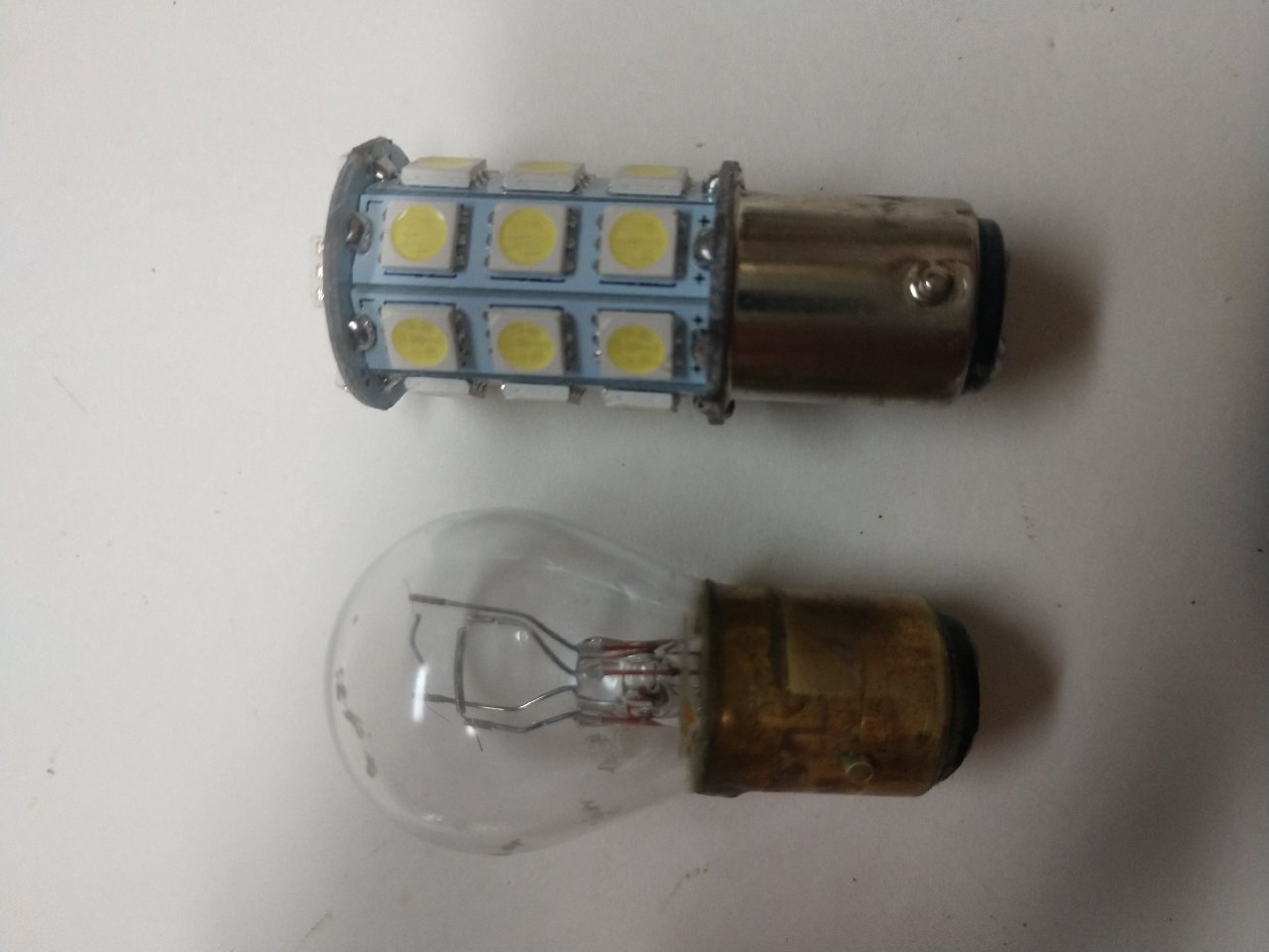

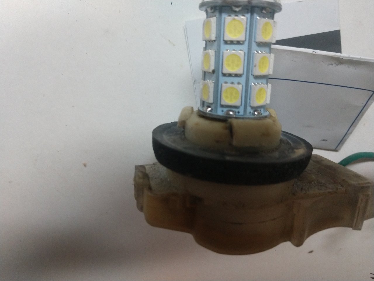

Time to upgrade the tail lights to LED units as they are brighter and use less power. I purchased a pack of 10 of these 25 SMD LED light replacements and they are bright. They will fit the GM sockets but due to the slight ridge where the base meets the LED circuit board the LED jams on the plastic housing by a small amount not allowing it to be pushed all the way in place. . . Tried to slightly grind the ridge away but the bond between circuit board and base is then compromised. Does anyone know if a replacement socket is available that will accept this bulb and fit the Fiero tail light housings?
This one shows the ridge that the LED bulb has not going in the socket

In one year, you will begin to lose LEDs. Those are crap my good man. Not your fault, just been there done that. The things jiggle like no tomorrow, and bust solders. I went so far as to fix them once, but crapolla.
Edit: The lights have 120 solder joints on them.  [This message has been edited by Tony Kania (edited 02-15-2020).]

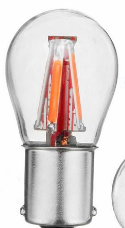

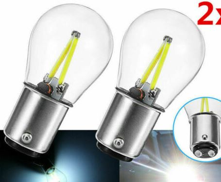

Thanks for the info guys but how about these LED's with the "filament" style COB strips?
or the white red color version. They are supposedly bright
Less connections possibly better reliability?

I like the initial design better than the squared off cree design. Please let us know what you find out. I have been replacing mine with the style you initially posted just due to availability and I can solder a joint properly. It gets old though when you have to continuously check to see if everything works.

How did you get those LED array units to fit the Fiero light sockets. The first ones pictured here do not fit in. The ridge between the base and the circuit board will not pass past the plastic housing.

| quote | Originally posted by Dennis LaGrua: Tried to slightly grind the ridge away but the bond between circuit board and base is then compromised.
That's what I do; I chuck the bulb base in the lathe, then grind away at the base with a Dremel + cutoff wheel.
As required, I would reflow each solder joint with fresh flux + a soldering iron.
For the couple of years I ran this type of LED bulb (constructed from a bunch of printed circuit boards), I didn't run into any reliability issues.[This message has been edited by pmbrunelle (edited 02-15-2020).]

I modified my plastic housings on the socket itself. Just enough to allow the bulb to seat all the way down to turn and lock it in.
