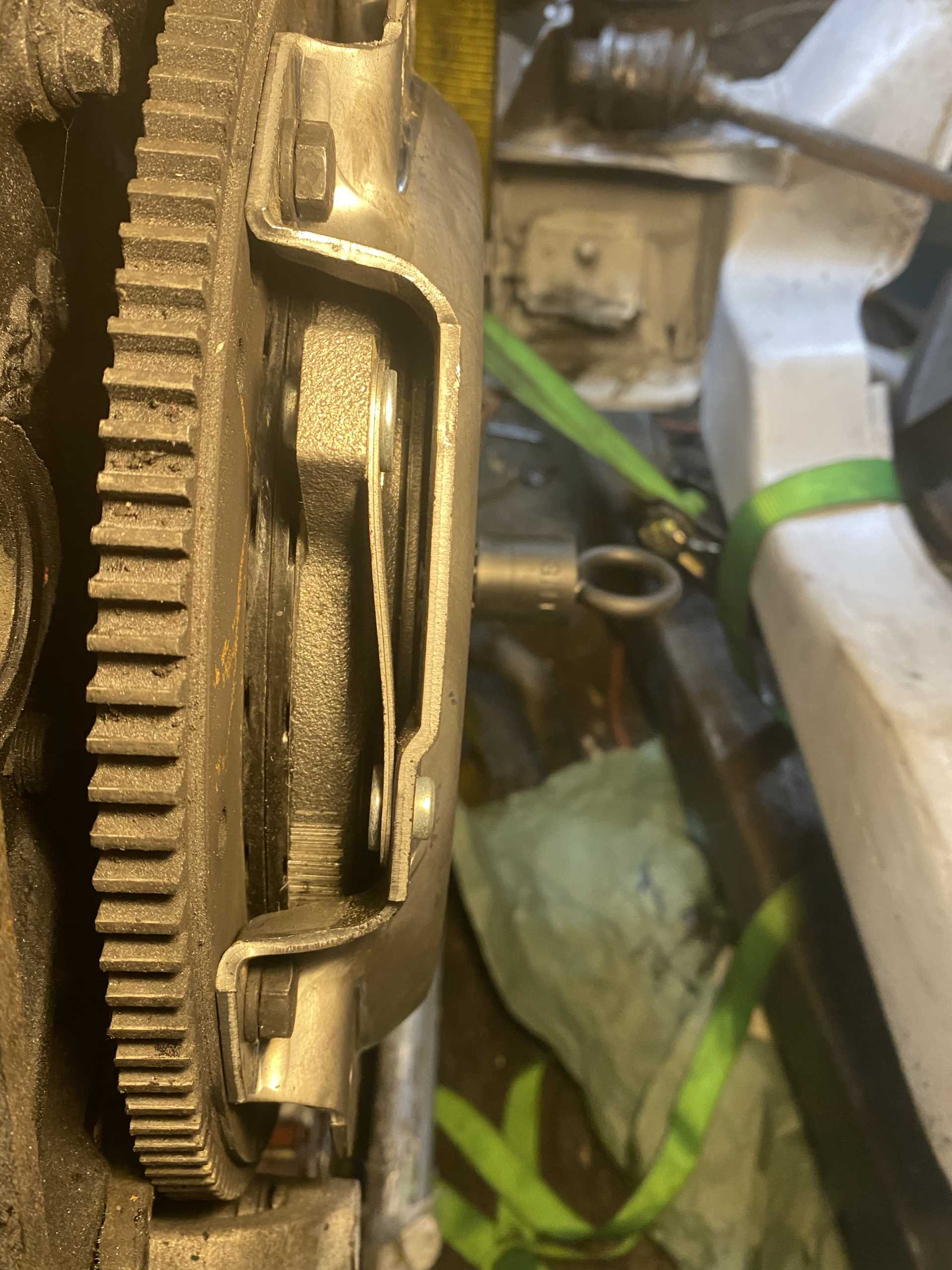

Does this look correct? Is it suppose to be right again the pressure plate right?
fierofool
FEB 10, 10:24 PM
Without the transmission installed, the disk is sandwiched between the pressure plate and flywheel. It's touching both. That's the position when the vehicle is in motion. The pressure plate face only moves away when the clutch pedal is depressed.
tmadia
FEB 11, 02:51 PM
Yes, that is what it is supposed to look like.
