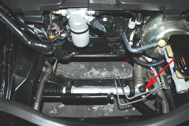

The other day I replaced my steering column intermediate shaft with a good one that had no play. Now, when I turn the wheel to the left, I get a noise from the rack. I pulled back the boot on the driver side and saw that the rack gear moves up a little bit when the wheel is turned. I'm not sure if it did this before and I just didn't notice it because of the play in the old shaft, or what.
This is a rack I rebuilt less than a year ago with new bushing, seal, boots, damper and tie rods. The pinion bearings were still good.
I have the preload set kind of tight. I tightened it up a little more to see if I could get that slop out, but it didn't help. I don't want to tighten it too much or it will be hard to steer. I'm not sure if this movement is normal or what. It doesn't seem to affect drivability. Any ideas?

I can check all of those things, but I can see where it is moving. It's like the pinion gear is pushing up on the rack gear when the wheel is turned. If I remember correctly, the only thing holding it down on the driver side is the preload mechanism, is that right? There is no play on center or anywhere else in the rack movement.

You might want to try adjusting the rack preload while on jack stands first. Don't overdo it.
Take the time to remove the spare tire tub. It makes things A LOT easier.
As does this http://rodneydickman.com/ca...h=27&products_id=126

I have an update: The other night I went out to my car after work and tightened the preload on the rack according to spec, and it's much better! There's no more noise or movement in the steering rack. All this time I was afraid I had it too tight, when it actually had quite a bit of adjustment left before it was in spec. Thank you for posting the image with the correct adjustment procedure!

This looks like a good place to start! Two questions: What is the function of the preload? Edit >> answered by theogre above "The "Preload" parts are the backstop pushing the rack into the pinon." <<
And how do you guys measure 2nm torque? Most torque wrenches don't have accuracy that low. I think mine starts at 5 ft lbs.
