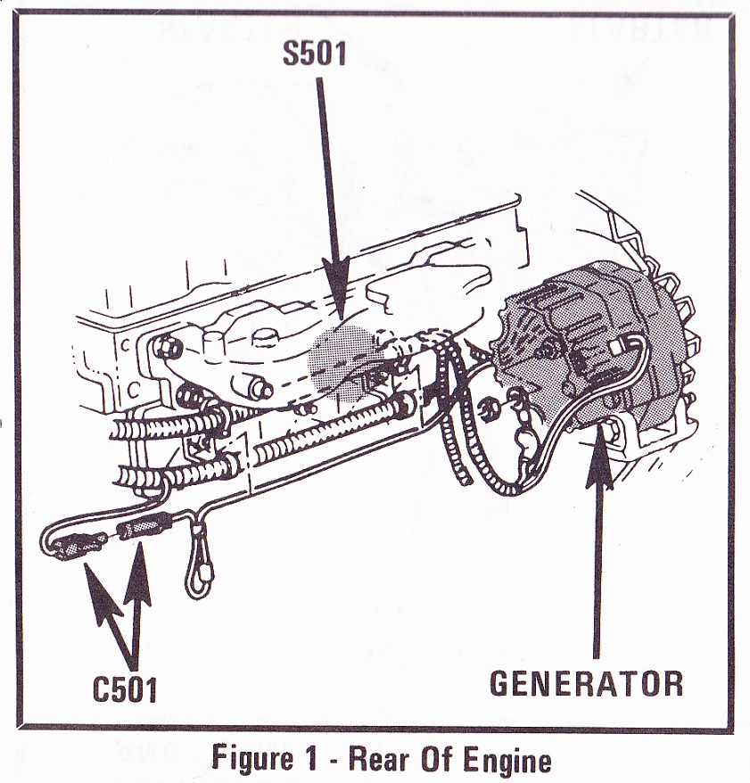

Disconnect C501 power to ECM clear it and to force it to relearn idle. It may not change much, but maybe a Code will come up after running.
Not sure where C501 is on 85 Duke, but on 84 it's in the wiring harness.

Pulling C501 likely won't help. Think 85-86 L4 is on the right side on head.
