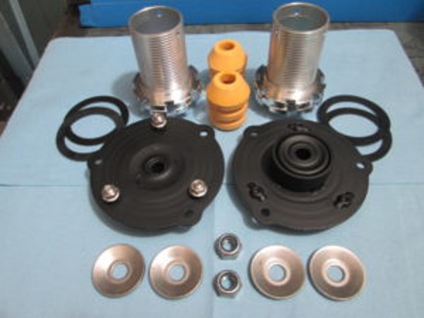

did anyone ever try this kit ?
https://www.ebay.com/itm/Sc...b:g:rUgAAOSwvcJZ8u6A
i was thing of cuting one ring of the rear coil but this will be much nice
i have a v8 350 tpi in the back and the rear still high
vette7584 JAN 21, 08:51 PM
i believe those to be like a set i bought, they wouldnt fit over the strut tube after i cut the perch off
IMSA GT JAN 21, 08:53 PM
Yes it's been done many times before. You can get them even cheaper if you don't care about the color:
https://www.ebay.com/itm/FO...100623%26rk%3D1%26rk t%3D6%26mehot%3Dpp%26sd%3D381863702835%26itm%3D381863696571%26pmt%3D1%26noa%3D0%26pg%3D2047675&_trksid=p2047675.c100623.m-1

You can use the perches from that kit and the hats but the springs are probably very stiff and short for your liking. I just buy another set of 12" #300lb springs.
