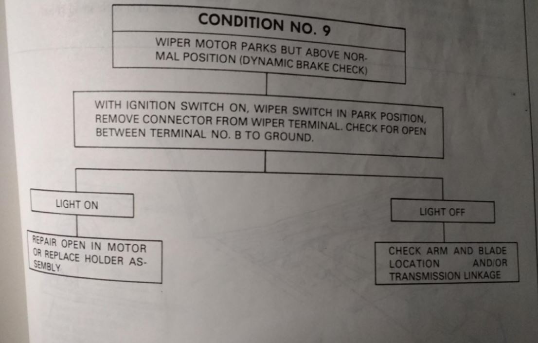

I found the following diagrams for troubleshooting, but I don't understand what I'm testing.
It says to turn the key on, switch to off and check for open between terminal B and ground. 1. Am I checking the CONNECTOR, or the Motor? 2. If I am checking the Motor, which seems like what I should check, why does it matter that the key is on and the switch is OFF when the connector is disconnected? 3. Diagram says if LIGHT ON replace motor. Isn't light on the same as 0.0 ohms/continuity on the multimeter? If so why does 0 ohms at motor terminal B to ground mean its bad. When I look at the wiring diagram, to me it looks like B is connected to ground when in the park position. Am I reading the diagram wrong?

I removed the new motor and compared new and old. Both read closed circuit to ground on terminal B, so it doesn't seem like there is any electrical problem. Nothing is corroded. My car has been garage kept in recent years.
Next I'll try to reinstall the new motor and pay more attention about where the wiper arm bracket attaches to the motor shaft. Seems like it really only goes on one way, but will double check this.

0Ω for B to Ground means Gear hit "Park switch" in Park position. Anything else the motor is Not in park and should show 0Ω between A and B.
A is "12v" From wiper fuse to run Delay Module/board to run motor to Park. B is Power to DM and "turns off" when motor is in Park. C is Low speed and used by Wash Delay and Park circuits. D is High speed.
C D and Ground is directly connected to run the motor.
