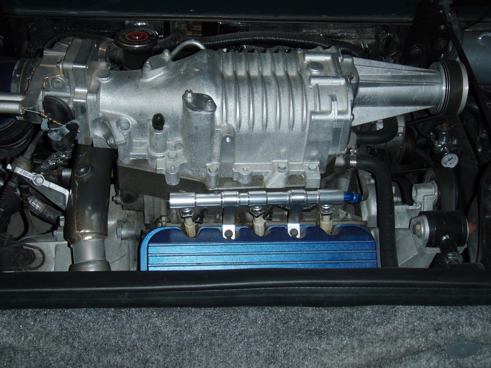

I have TOG headers on a 3800 SC Series III engine and am satisfied with them but do not really know if they add 20-30 hp. You should note that I tuned conservatively for reliability instead of absolute max HP. The dyno run showed around 300 HP at the wheels with a Getrag 282 transmission. I suspect that I could get a bit more HP out of this engine with a pulley change and/or tune mod. The current SC pulley is a 3.4" diameter but I have 3.0" in my storage area if I want more boost.
Current engine mods are as follows:
TOG header larger intake and exhaust piping ZZP intercooler ZZP fuel logs Northstar TV 3.4" modular pulley VS cam 85 mm SLP MAF Ceramic coated exhaust
.JPG)
Nelson[This message has been edited by hnthomps (edited 01-24-2020).]
