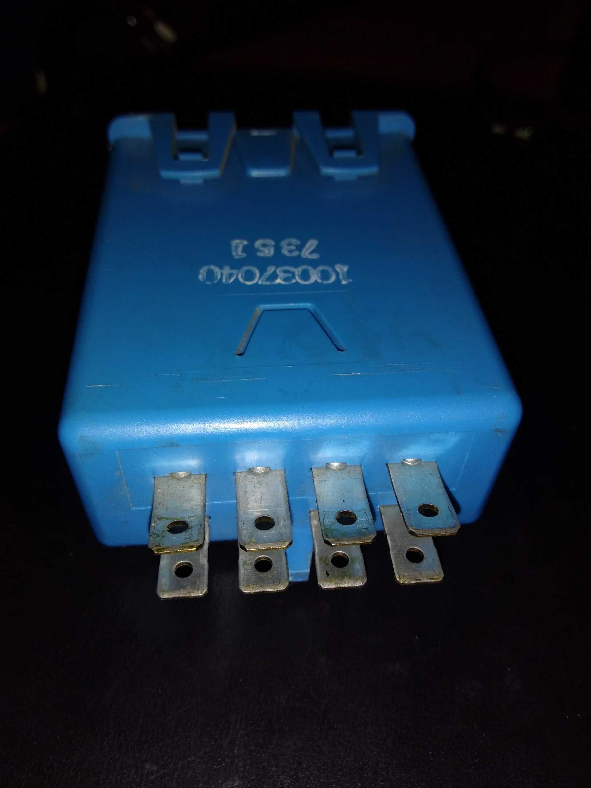

It was loose in the trunk (previous owner) and I am curious to know what it is for

Blue Dingy Thingy. It makes the dings when you leave your lights on, keys in ignition, etc.
It plugs in under the passenger-side dash.

Some just hate them but likely is in the trunk because is defective and often chimes when shouldn't.
See my Cave, Chime Unit If true most are easily fix but need careful soldering marked areas to Not damage the board.------------------ Dr. Ian Malcolm: Yeah, but your scientists were so preoccupied with whether or not they could, they didn't stop to think if they should. (Jurassic Park)

Ironically, GM called it the Convenience Center. But when it starts malfunctioning (which is common), it's anything but convenient.

Mine worked correctly, but I've been doing a lot of tests lately with the key-on and the door open, so it me drove nuts. Or tests with the lights on and the door open.
I could only handle about 15 minutes of ding-ding-ding before pulling out the sucker. Not sure if I'll replace it. I'll keep it in a safe place should I change my mind.

Everyone may think that I am CRAZY, but I purchased a used chime because the one in my car didn’t make any sound. Even though my parking brake is marginally effective, the chime ensures that I release the parking brake before moving the car. The way the lever lays on the floor, makes it way to easy to forget the parking brakes is engaged. I also will forget to turn off the headlights, as most of the newer cars have headlights that turn themselves on at night. Bad habits are hard to break.

Very likely The plug it goes into is the Convenience Center or that plug, horn relay, and hazard flash can are included in that name. What name attach by iffy authors for all GM FSM often has problems to completely wrong. Worse they copy/past same iffy data to other FSM for other models. (Same reason Fiero 84 85 and 86 FSM has many errors in rear brake section.)
Most GM parts sources have chime box listed as Alarm Assembly or just Alarm. Some have a full name but used like military part name... Example: GMPartsGiant.com is Alarm Asm-Seat Belt, Ignition Key & Lamp
Side note: Lectron that made them calls them simply a Tone Generator in US Patent # 42547036 etc. (Lectron Products, Inc. was bought out by Eaton in 96.)
Unlike Other cars "chime box(es)" etc that you have to dig under the dash in more places. Example: Many old Ford cars had "chime box" and hazard can hidden under P-side dash and very hard to get at. I often had to remove glove box screws to reach them easier. Often they Didn't have Horn relay at all or hidden someplace else.
quote | Originally posted by Eliredandblack: Everyone may think that I am CRAZY, but I purchased a used chime because the one in my car didn’t make any sound. Even though my parking brake is marginally effective, the chime ensures that I release the parking brake before moving the car. The way the lever lays on the floor, makes it way to easy to forget the parking brakes is engaged. I also will forget to turn off the headlights, as most of the newer cars have headlights that turn themselves on at night. Bad habits are hard to break. |
There's that and even before new car timer HL turn off... Many have bad HL motor(s) or disable them in winter and if needed for bad weather driving during daytime easy to leave HL etc bulbs on and kill the battery.
Many I-key switches are "bad" and don't chime w/ key in the lock sometimes or never. Many don't fix the switch because is buried in the S-column. HL light chime is disabled turning Dash Dimmer off.
