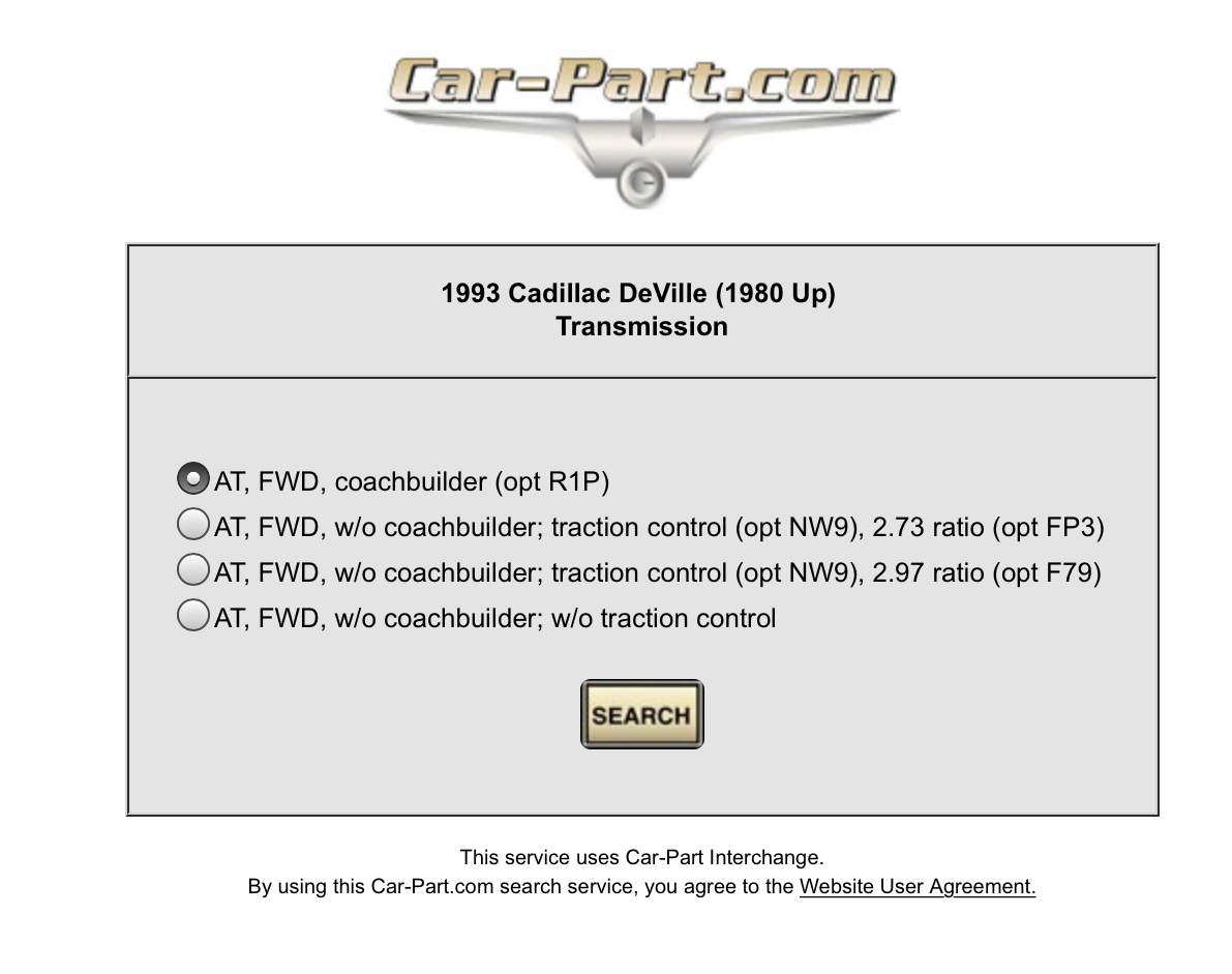

When doing a transmission search on car-part.com, these are the transmission options when looking up a 93 Deville...
This isn’t even showing a 3.11 ratio, but 2.97 and 2.93 (meaning even worse than the 3.11?)

The 4T80E was *ONLY* used with the Northstar. You definitely do not have that.
3.11 may refer to the combination of chain ratio and final drive... So a 2.97 final drive with a 1.05 chain ratio = 3.11. I'm not the expert on what parts were actually available or built, however.
3.11 is a lot of gear for a low-revving engine like the 4.9.[This message has been edited by Will (edited 01-14-2020).]
JAN 14, 01:33 PM
The 4T80E was never used with the 4.9 V8. The only transmission used with the 4.9 was the 4T60E. The 4T60Ewas used with several GM engines. It is easily identifiable..... No throttle valve cable Vacuum modulator Electrical plug faces forward
