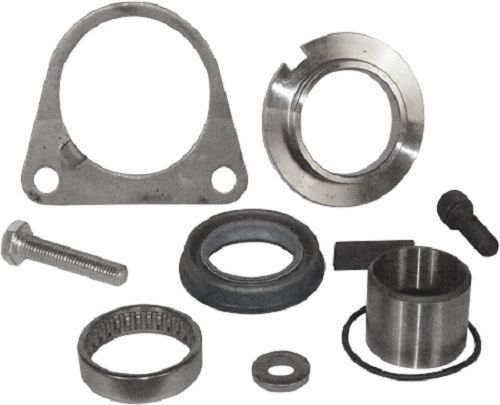

If your bearings have too much play GM made an axle bearing stabilizer kit for the TH125 transmission.
I used them on my Getrag that had leaking seals and it has worked good so far, about 3,000 miles. I found the kits on Ebay. Part numbers for the kit are 8643931 or K75125.

quote | Originally posted by Larryinkc: If your bearings have too much play GM made an axle bearing stabilizer kit for the TH125 transmission.
I used them on my Getrag that had leaking seals and it has worked good so far, about 3,000 miles. I found the kits on Ebay. Part numbers for the kit are 8643931 or K75125. |
These should work better then most others because has a sleeve for inner race. Others don't have that and many users ruin the inner CV because CV Metal isn't harden to run as a part of roller bearing there.
Think is/was picture(s) of results w/ cheap units w/o the sleeve somewhere in archives but I'm not looking to find it/then now.
You can't run this on Left/driver side of TH125c and others. No anchor bolt(s) there etc. Is hard to even replace the standard seal there.
