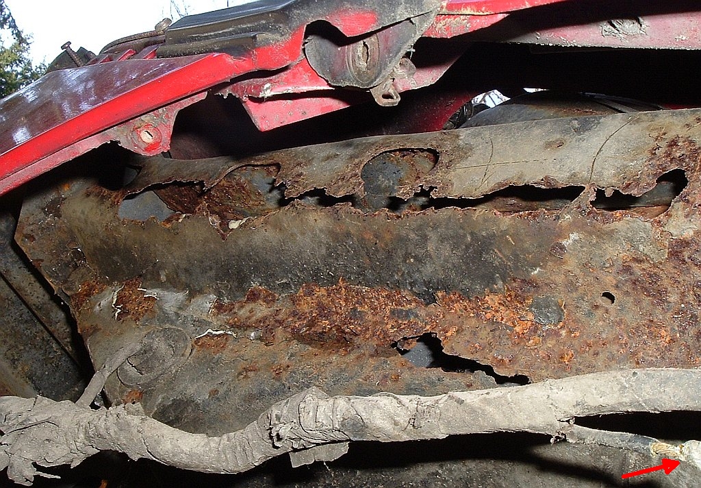

Check the ground located behind and above the passenger side rear wheel well liner. Sometimes corrosion of the rear upper frame rail leads to a poor connection of the ground located there.
This image shows the ground wire which became completely detached from an upper frame rail due to extensive rust.

Problem solved.
Thanks for the recommendation. It was a ground. Now, all lighting works as they are supposed to.
