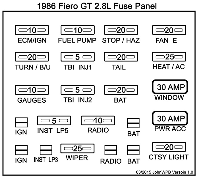

Fan speed switch does not turn blower fan on in lower settings or on high speed. Constant power at the high speed relay (red wire) When key is 'On', servo motors move the flaps When key is 'On', tested power on the the two brown wires on the power relay, Red wire, constant power on the high speed relay, no power at the fan speed switch, no power at the blower motor. Fuse (FAN) is good, however, I swapped it out and still no power at the blower motor or fan speed switch with the key at the 'On" position. Tested the motor with a 12V power source, and it works perfectly. Resistor was replaced, but no power on any lead of the resistor with the key at the 'On' position. Both power relays have been replaced, still, the high speed power relay Red wire has constant 12V, both key 'Off' and key 'On'. Again, with Key 'On', both brown wires on power relay (lower speeds relay) have 12V. Red wire on high speed relay is constant 12V, but no power to the blower, no power to the fan switch selector, fuse in fuse box is good, with fan plugged in, no power to the selector switch.

Check the 25 amp fuse HEAT / AC.
