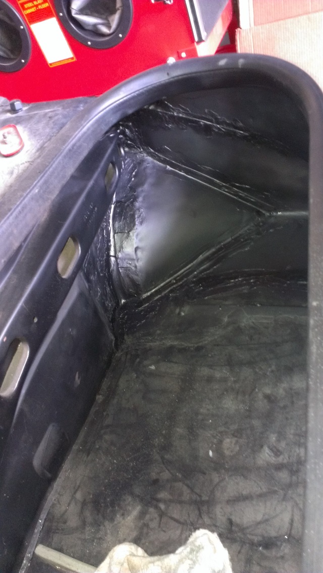

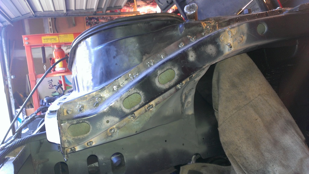

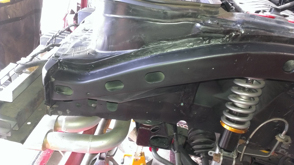

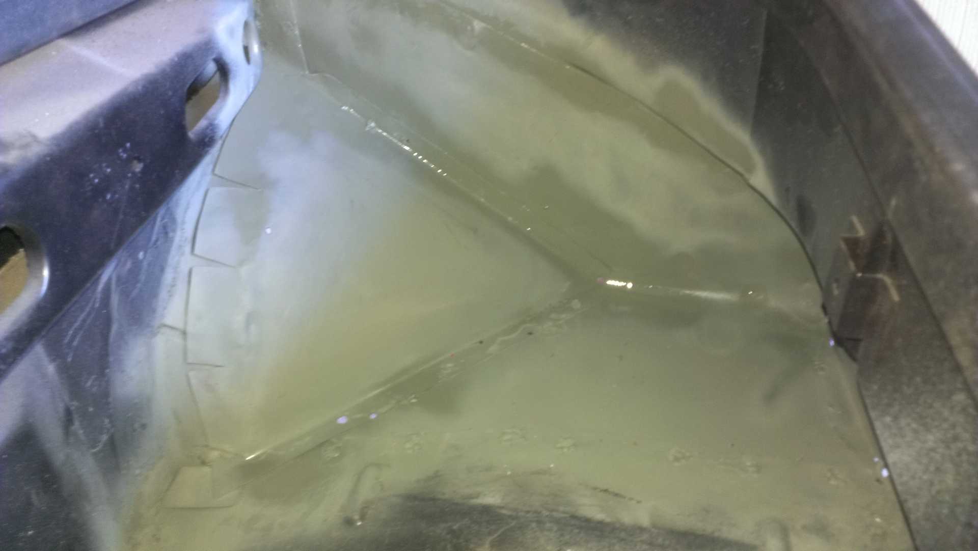

RWDPLZ JAN 04, 10:52 AM
Originally posted by Patrick:
... but to go through all that trouble for a rotted out '84?
It's been done...
http://www.fiero.nl/forum/A...160323-2-121544.html
One of the previous owners had this car in Grand Rapids, it's always been a Michigan car (except the two years I had it out in California). I also did this work in a freezing garage in Traverse City in January/February.
If you want an intact space frame, you'll have to look outside Michigan and get one shipped in, and you definitely want to go look at it before buying and shipping unless it's already stripped.
Patrick JAN 04, 03:49 PM
Originally posted by RWDPLZ:
It's been done...
Yes it has, and I've commented before that I greatly admire what you were able to accomplish. However, few of us have the time, determination, skillz and resources to duplicate what you've done!
