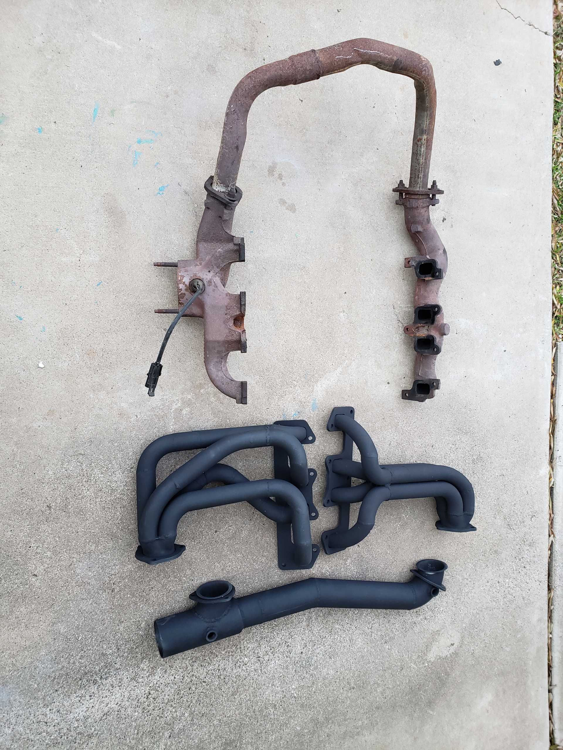

Spadesluck
DEC 30, 06:47 PM
I highly recommend you to use John to build you some headers. The stock 4.9 stuff leaves a lot to be desired. Here is a picture of the stock stuff compared to what John built for me.
With this exhaust everything is routed just like stock.[This message has been edited by Spadesluck (edited 12-30-2019).]
