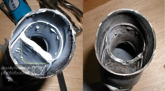

I have read about porting the manifolds, but not about the restriction in the crossover. Is there a restriction at the connection with the manifolds?
DEC 29, 08:47 AM
The restriction in the crossover is at the merge of the two pipes.
Blacktree
DEC 29, 01:09 PM
Yep. The two top pipes are squashed, to fit into the bottom pipe. The fix is to cut back the center wall, where the 2 pipes are pressed against each other.
Or you could buy the Fiero Store y-pipe. It uses a 2-to-1 header collector, instead of squashing the pipes.
Notorio
DEC 29, 11:40 PM
Here is an example that I pulled from a post in the Forum many moons ago so I don't know who posted it originally. If you search for it I've seen two ways to tackle this: the way shown in this picture where they completely sectioned the pipe vs cutting a window into the side ...
