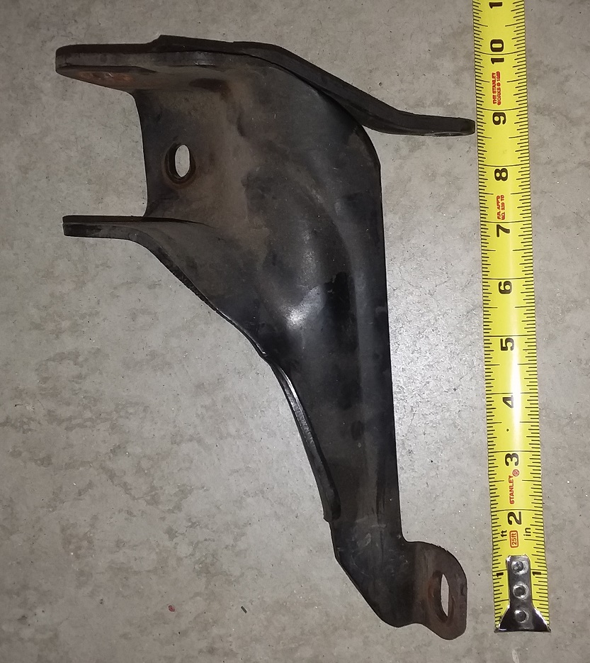

Putting my long-slumbering 88GT 5spd back together and have at least one part I can't figure out where it goes. If I run into more part mysteries I'll add them up top here. Subtle clues, hints, or downright directions welcome:
1) Part one. Large bracket. I thought it went with the A/C but none of the diagrams and photos I've found on the Forum show this sucker.

That is (part of) the dogbone mount bracket for a 2.8 Fiero.
It bolts to the RH cylinder head.
A reinforcing piece secures this bracket to the LH cylinder head.

Bravo and many thanks!
