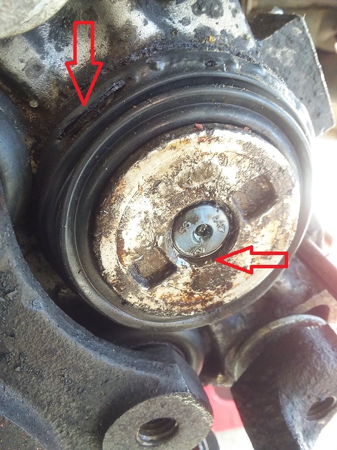

As many of you know I'm putting my 88GT back together after some engine work with 18 months flying by. I noticed that the driver rear suspension looked a bit greasy. Thinking it was some engine cleaner that hasn't evaporated I took the brake apart and notice much oily muck that looks like it has been flung out from a small leak. The black paint on the back of the inboard pad has been softened up and eaten away, clearly the work of brake fluid.
In this picture there is a large gash in the boot and a small drip exuding from the small seal. Guess this means the piston inside is leaking a bit. AFAI recall from 18 months ago the brakes seemed to be working fine. Looks like I'm going to need to get a rebuilt caliper for this.

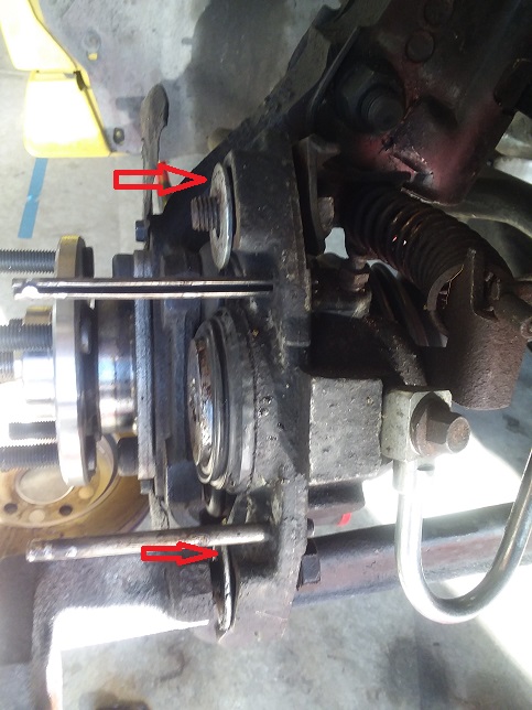

In this second picture I'm deeply suspicious of these two large washers going in between the two halves of the caliper. Without taking the other side apart it looks like this is a rig from a prior owner. Can anyone confirm these washers don't belong here?
theogre DEC 18, 06:49 PM
1. Leaking thru dirt boot anywhere = main "o-ring" behind it is "bad" and can be fixed...
If that's top of the boot, boot is likely full of crap, water, and brake fluid. Main O-ring leaking can be any where and not = same bad spot in a boot.
But...
2. Leaking thru front "vent valve" = piston is bad. More specific Inner piston and Seal you never see have failed.
See my Cave, Rear Piston notes etc. because most of 88 is same rear brake design as older Fiero.
Be Warned that Any "method" to "fix"/"rebuild" a bad piston often fails again and when does can cause pad drag and other problems leading to brake failure or even a fire.

theogre DEC 18, 06:55 PM
And yes... the washers are signs of a moron working on brakes.
Likely idiot can't retract bad piston and new pads won't fit so made more clearance then sold the car.
Patrick DEC 18, 07:13 PM
Wow, some people should not be allowed to work on cars... especially brakes! That's scary.

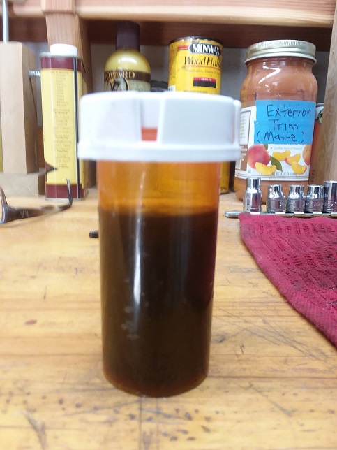

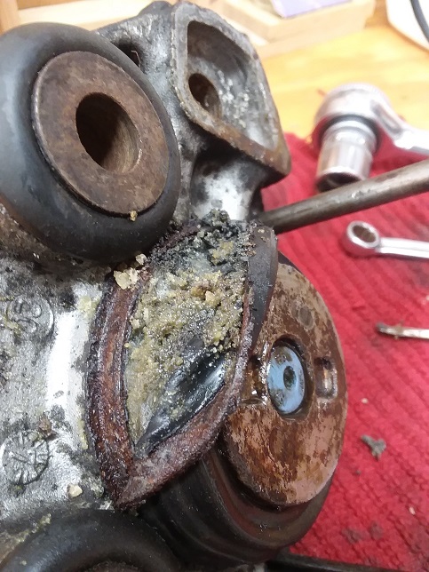

That is a great find on the rebuilt calipers. Unfortunately for me I don't think my caliper will qualify for a Returnable Core, which raises the price to $175. Turns out there is a large gouge on the piston outer surface. The inner piston retaining ring looks like it has been beat to hell and the bearing is in pieces
Ogre called it on the sludge ... check this out
The brake fluid that drained out of the piston was also dark brown ...
