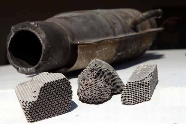

The Fiero V6 cats are a honeycomb matrix- non-restrictive....I doubt if you would notice any difference either way by removing it...just stinkyer exhaust. I have an F-body 3.4 long block under the original '85 induction system. I lost the cat back a few years ago....Bought a new one and drove to Hayward to have it installed....after, I could not feel any difference- But I did not try to quantify the situation......
