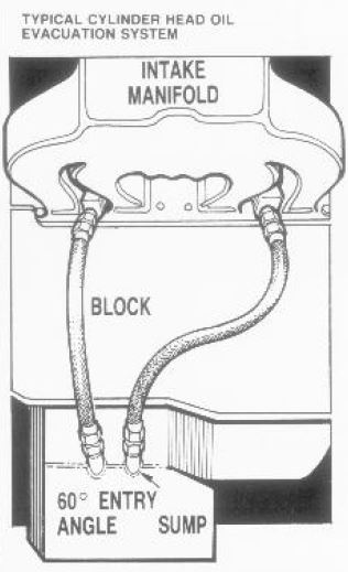

I have same Moroso oil pan with oil return lines as in this picture (not mine) - from here:
http://www.realfierotech.com/viewtopic.php?t=18096

Did you also add oil return line fittings to the stock oil pan?
[This message has been edited by fierosound (edited 12-12-2019).]
edfiero DEC 13, 06:00 AM
Yes.... as much as it pained me to drill a hole in the side of the pan, the return was installed.

Talked to my engine builder today. He said it doesn't need return line because of return holes in the head. The man doing the actual work agreed. He use to race boats with a sd4 but with a Chevy head. He said it was pushing 360+ hp. Is the 437 head different than the 433 ? What's your thoughts ?
fierosound DEC 16, 07:40 PM
I'm sure Vanderley/Huffaker had the drains from the intakes for a reason.
Probably faster drain back into the sump because oil isn't being flung around by the crankshaft in the crankcase.
Likely OK since you won't be running 8000-9000 rpm, but if the valve cover fills up, you'll know for sure.
