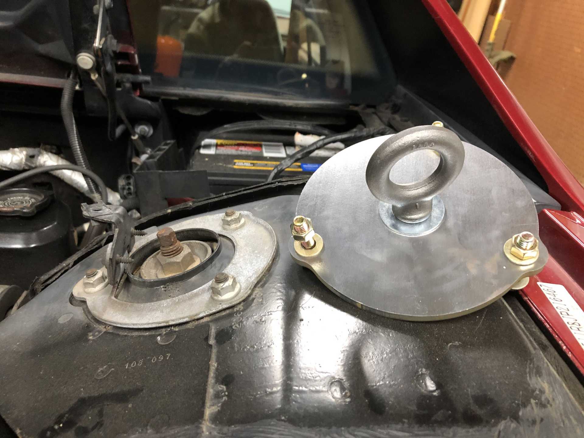

I've gathered the following parts to date: -Ecotec 2.0L LSJ -ZZP Dual Pass Intercooler Endplate -GM F40 6 speed Transmission -Haltech Elite 1500 w/ Wideband O2 -Self-designed strut tower lifting plates -Harbor Freight Gantry Crane

My planned Fiero-hoisting setup

My planned Fiero-hoisting setup...
I'll give you an "A" for effort... but there are two holes on the front trunk wall (under the carpet) that are perfect for hooking a lifting chain into.

I'll give you an "A" for effort... but there are two holes on the front trunk wall (under the carpet) that are perfect for hooking a lifting chain into. |
I've been a lurker and researcher around here for awhile and I'm aware of all of the different philosophies (mostly trunk latch or trunk wall holes) for lifting the rear of a Fiero. While I realize that both methods have been used with success by dozens of people, I'm more comfortable loading something that was designed to take high vertical loads. That and it gave me an excuse to brush up on my Autodesk Fusion 360 skills and test out eMachineShop on a fairly non-critical part.

I've been a lurker and researcher around here for awhile and I'm aware of all of the different philosophies (mostly trunk latch or trunk wall holes) for lifting the rear of a Fiero. While I realize that both methods have been used with success by dozens of people...
Over the course of 35 years, I suspect it's been a whole lot more than "dozens of people".
I wouldn't trust the trunk latch method myself, but IMO the Fiero's trunk wall is more than robust enough for lifting purposes. Some people are adamant that those holes were actually put there for that very purpose.
