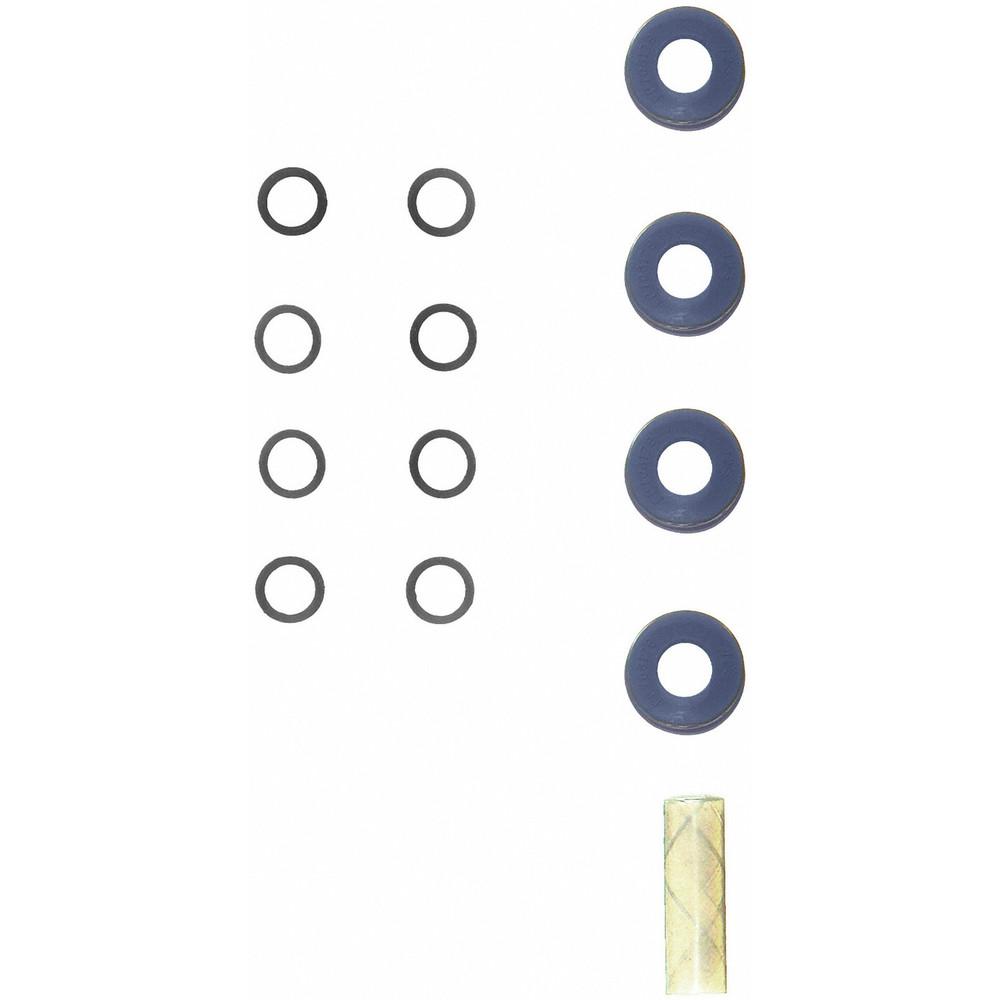

So I think the shop didn't do those (receipt claims they did) or didn't do them properly. Is there a trick to those stem seals? I see different types sold with different sizes and if somebody could point out to me the correct ones I would be thankful. They are cheap and from what I see it's an easy job - just need to take the valve cover off?

And what about the parts themselves? There are little rubber orings and "big" seals available, how many of those goes where? The manual isn't too helpful in that regard.

Thanks. So from that write-up I guess I need 8 oring seals for both exhaust and intake stems and just 4 cup seals for the intake ones?
There are different sizes from what I can see... My valves are original, the shop said they were good so I didn't order them for the rebuild. Guess I should take the valve cover off first and measure the stems?
EDIT: Also there are different materials available, silicone, viton. Which one is better?
