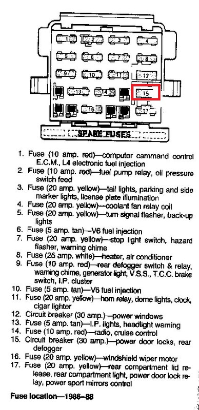

Can someone point me to the location of the door lock fuse?
Or point me in the right direction to troubleshoot?

I installed a different system (Avital 2101L) but they don't vary all that much. Your system may have a fuse built in to it; if so check that. The door locks are powered through the Power Accessory circuit breaker, but the Door Lock Switches and Relays are powered through the CTSY/LID fuse. Both are located in the lower right corner of the fuse block (if you're looking at it such that the legends are right-reading).

I did find the this fuse 15 on the fuse block. But I think its good because I swapped Fuse 15 and 12 and the power windows did work.
Is this the only place I have to look?

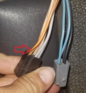

Just checked the two plugs that go to the door lock module . The one that is locked on the Passenger side under the dash.
Only the orange\black wire has power. Could it be that I messed up the module where the plugs connect too?
What wires would I use to bypass the module and jump the wires to test?

I'll get a look at my FSM and other info from my install and let you know what to jumper to test. In the meantime, check also Fuse #17 - includes the Power Door Lock Relay (but if power trunk release, trunk light, and power mirrors work then this fuse is good).

+12 on ORN/BLK wire only is normal. Everything else is switched by the lock/unlock switches and the Door Lock Relay Assembly (the 'module' by the right side kick panel). I'm assuming the wire colors in our photo are a bit washed out. You should have ORN/BLK, LT BLU(2), BLK (2), GRY(2) and TAN(2) - 9 wires total. The Ground connection for this Relay Assembly is the mounting - make sure it securely bolted down.
Since the Door Lock Relay switches both +12 and Ground, some tests with jumpers will require connecting two jumpers at once. All you need to jumper anything for test is a wire a couple of inches long with the ends stripped. If you have the choice, I'd recommend 16 ga. or larger, maybe 3-4" long, ends stripped about 1/4".
Since you said there's power on the ORN/BLK wire, I'll assume you have a meter or a test light. You can find out most things with that. If you connect your meter/test light between the LT BLU and GROUND (Relay case), and press (and hold) the door LOCK switch, you should see battery voltage. If you connect your meter/test light between the BLK and GROUND, and press (and hold) the door UNLOCK switch, you should see battery voltage. Do this with both switches. (If only one works, the switch that doesn't is bad, or its wiring is) If these tests work, you're good up to the Relay Assembly. If you connect your meter/test light between the GRY and GROUND (Relay case), and press the door LOCK switch, you should see battery voltage. If you connect your meter/test light between the TAN and GROUND (Relay case), and press the door UNLOCK switch, you should see battery voltage. If these tests work, the Door Lock Relay Assembly is good. (There are ways to substitute this since it is not available new AFAIK. Used ones may be available.

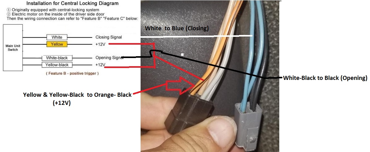

str8maxn DEC 15, 08:11 PM
OldGuyInaGT- Thank you very much for the help... Turns out the first paragraph of your troubleshoot had the solution.... All I had to do was ground the Stock Relay.
I have the lock and unlock figured out and working. I'd like to share this pic and hope it helps people in the future.
This is what my wiring looks like:
All I need now is the trunk release. If you or anyone else can tell me where the wire is located and what wire to use for the trunk release that would complete my mode. ( I have a 1986 GT)
