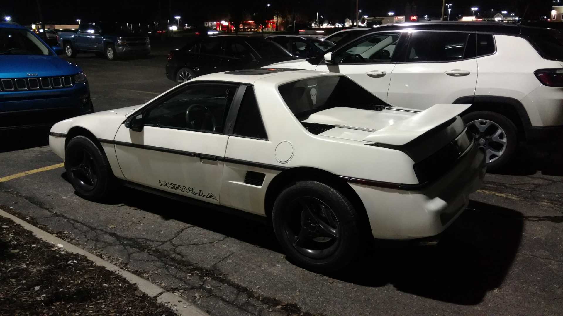

my name is mike, this is my FIRST FIERO, 88 white formula 2.8 auto rust free (i checked). i am having an issue to where i cant set it properly, aka i know the drill bit is a 3/32, and to stick it on hole when pushed down and bolts loose. but my knowledge ends there. it cranks when i jump it, so no issue there. i honestly just wanted to change it cause it was original, i am restoring it, sat for a little. i cant find any video and apparently my brain is blocking me from understanding the ****ing directions i guess?
i myself did all new pads, rotors, calipers, lines, fuel pump/filter, all new injectors, all new sensors, had to fix fuse box wiring with my eyes closed, and this has me so stumped lol :sigh: either way im having it towed to my buddys shop tomorrow for work i dont have time to do. if someone can help me a bit here and i can align it/install it correctly, i will soil myself. id prefer to drive it there! it runs like new 98k miles and shifts beautiful, already did trans service.
i already ****ed one up and drill bit kinda went all the way in THANK YOU TO ANYONE WHO HELPS!!!!!
