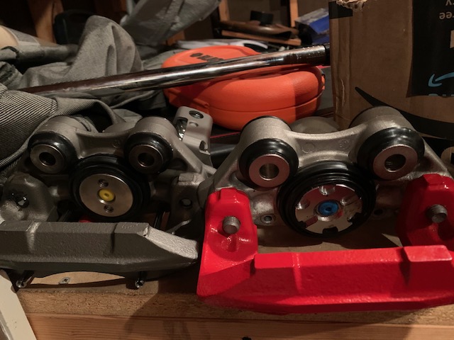

I recently had a leaking caliper and decided to order a rebuilt caliper from TFS. It arrived and it looks great. It is the unpainted one in the photo. The piston is original, as they are apparently not available anymore.
In the meantime, a local caliper rebuild shop told me that he can rebuild 88 calipers (seemed confident and says he is aware of the differences between 84-87 Fiero calipers and the 88 ones) and he says the pistons are the same. I realize that they are officially slightly different and were a different part number
I have installed one of his rebuilt calipers in my car and so far so good. No leaks and it seems to be working fine.
Just wondering if anyone agrees or disagrees with his assessment that the pistons from earlier Fieros would work fine. The face on his pistons is clearly different (the red painted one in the picture)
I have only driven the car once since the install and it is now stored for the winter, but it seemed to work fine and so far has not leaked. Does anyone recognize the piston on the red one?
thoughts?

Any opinions on the difference between these pistons?

cam-a-lot
NOV 18, 12:58 PM
Thanks for the reply
My question was whether or not the piston in the picture (red caliper) was familiar to anyone else, since apparently the 88 piston is no longer available.
NOV 18, 04:27 PM
"Red" is "New Type" piston w/ notches for stamped SS pad clip for 84-87 Fiero and likely others.
 | CLICK FOR FULL SIZE |
84-87 Fiero rear piston Is Not same total diam as 88. Only same in the guts for E-brake function.
Piston Size: 47.75mm (1.88") 88 Front and Rear Piston Size: 47.57mm (1.87") 84-87 Rear Piston Size: 49.05mm (1.93") 84-87 Front From Cardone.com 88 MC size: 24mm (0.9448818898") per ACDelco
(Note that these numbers can change a bit in different "books" used. I have older rear listed as 45 then "updated" to 48mm on one page in my cave because of catalog data. Some cat's are just errors, others round up to whole numbers. If you follow rounding rules, both are 48mm but isn't for people designing or working on them.)
May seem to work and Yes, Seems very small dif but 88 shell w/ 84-87 piston can have seal leaks etc because of total size diff. GM et al make the main piston seal to fit a specified bore AND the piston in that bore. Tiny piston size change makes the seal compress more or less. Less here old piston w/ 88 seal. Tight/loose seal can effect piston self adjust etc. Plus will make rear brakes weaker because of hydraulic rules but you might not tell for normal driving.
Lower Performance? How bad? See my Cave, Brake Upgrade DL excel sheet and adjust to used 88 MC size and both pistons. Unprotect the sheet then just enter diam and sheet should do the rest. I get...code:
Setup MC mm MC area Cal mm Cal area Ratio Change vs Stock Rear OE MC & caliper 24 452.389 47.75 1790.757 3.958 0.000 OE MC & Old piston 24 452.389 47.57 1777.281 3.929 -0.030
At the very minimum... If you run older piston you need to run them on both sides on rear axle or likely have brake steering problems, one wheel locking more/easier, etc.
The Ogre's Fiero Cave[This message has been edited by theogre (edited 11-18-2019).]
