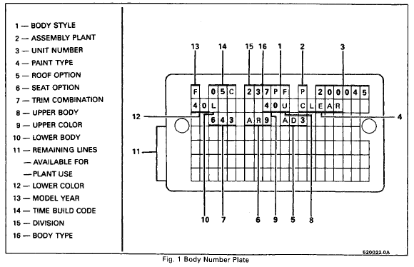

Metal Stamped VIN for all years atarting at least in 1970s... Obvious one is on dash so cops etc can see it thru windshield. "Hidden" one is on the frame. AKA Body Number Plate. Just where depends on year and model. I've seem but can't remember exactly where on Fiero. FSM Says...
quote | BODY NUMBER PLATE The Body Number Plate (Fig. 1) is attached to the front tie bar behind either the right or left headlamp in the engine compartment on all models. The Body Number Plate identifies numerous items as outlined in Figure 1. |
