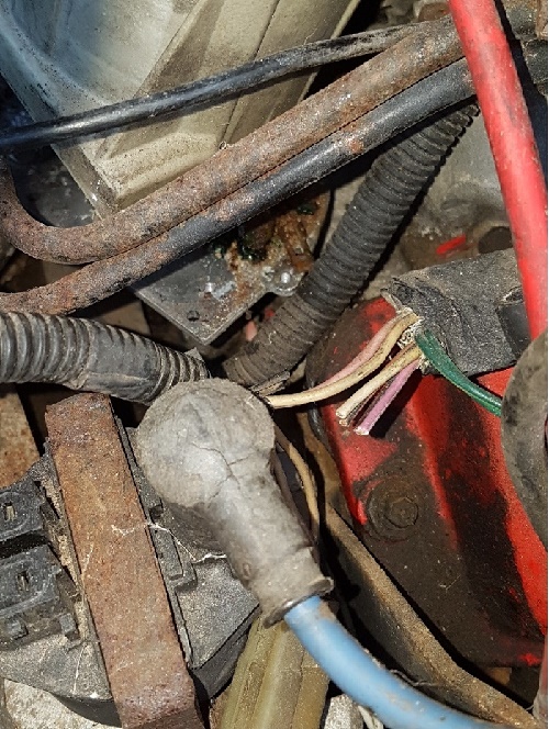

Hi there, First day digging into the Fiero..... It has been standing in a barn for a good few years. Found this loom missing probably a connector. Unfortunately I can't appear to post a picture off my phone, and having read the bewildering PIP thing I can't use that either as I don't use a computer at home. ...

Here is Bruschi54's picture

Is 2 pink and 2 white wires cut? missing the coil connector. anything will have HEI wiring as it does matter which color goes to A & B plugs on coil.

Yep, the black connector is missing. There are two other wires in that cluster of wires one which is brown and black and the other red and black. What are they supposed to be connected to?

I can use a few expletives ....... yes its missing... a gaping void on the the dizzy......

So the connectors for it are missing too I suppose...?

Oh yes....... hence the cut loom I suppose.....
