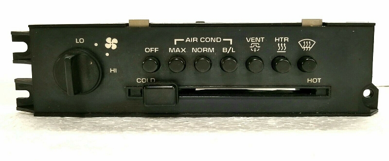

As we move into colder months I tested my heater earlier (88 gt V6). I noticed air coming out the defroster vents on the dash by the windshield but none from the front facing vents. This isn’t normal is it? I still had the slider on “cold” not sure if this effects anything.

You have three options... the defroster vents, the center vents, or the floor vents. Only one can be selected at a time.

How would I get hot air to come out of the center vents? I clicked the heater button on the A/C panel, is there something else I need to click or adjust?
NOV 10, 01:24 PM
quote | Originally posted by chaotichamster9:
...on the A/C panel
We've now at least established that your Fiero is A/C equipped.
What happens if you push the VENT button?

Select 'VENT' - Move TEMP slider to 'HOT' - Turn FAN switch to desired speed....
