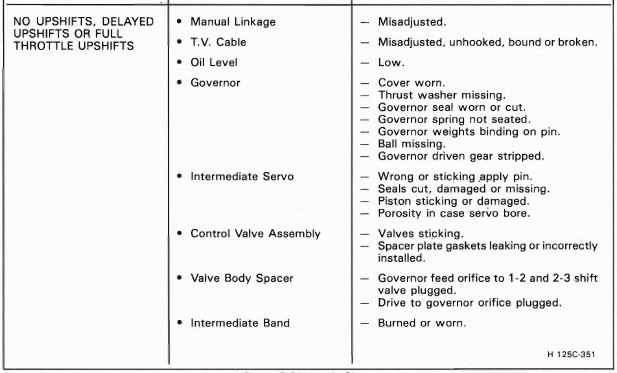

Diagnosis chart in Factory Service Manual - Hydraulic Diagnosis page 125-C3 indicates shift points in MPH not RPM. You should check what your car is doing against that chart.
When I still had an automatic in my Indy, TV (Throttle Valve) cable adjustment made all the difference in shift points. I could practically make the tranny shift "too soon" OR "too late" with it.
