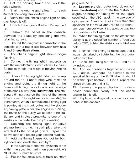

Use a timing light. Pages 1-22 and 1-23 in the Haynes repair book.
I usually just connect to spark plug #1 and set to 10 degrees BTDC.

I don't have a timing light, so I will have to buy one and try that out. I'm not sure where those timing marks are. Hopefully I can find them.

I purchased a timing light and I adjusted the timing to 10 degrees. It had been around 16 degrees, so obviously that was a problem!

OCT 27, 07:47 PM
quote | Originally posted by CookesForChrist:
Now, just today I was able to set the timing at 10 degrees.
And you did this with the ALDL jumper in place?[This message has been edited by Patrick (edited 10-27-2019).]
