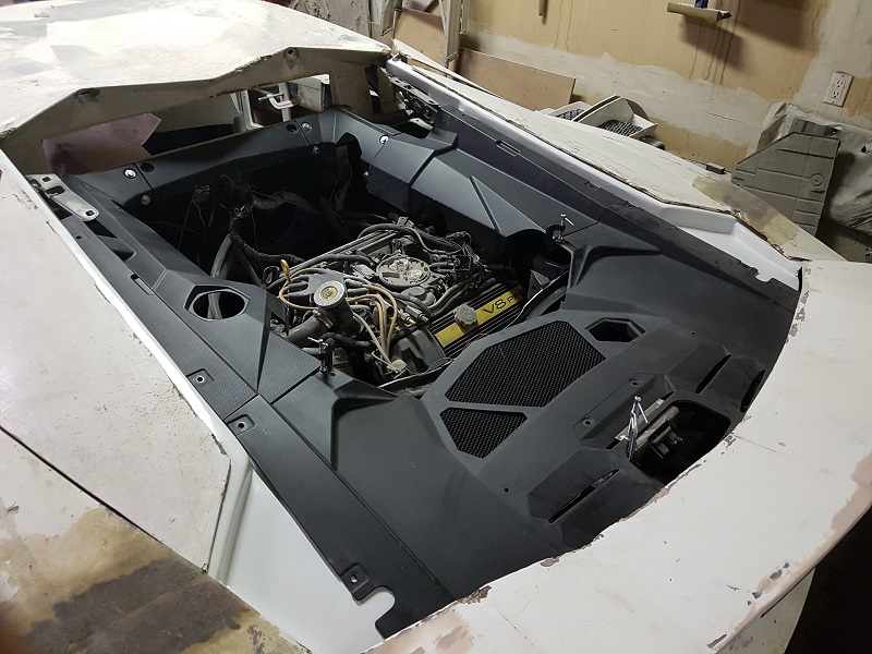

Actually, this is a good question. I have to move my 4.9 alternator down low as well. I'll also be adding the AC compressor so the two will need to be positioned in the same area. Unfortunately, I can't use a smaller alternator above as it will interfere with the engine trim that I'm using (Aventador replica). I remember seeing some pics of the low alternator configuration when I was doing my 4.9 build... but couldn't find them when I looked for them recently.
 [This message has been edited by Neils88 (edited 10-22-2019).]

Mine fit perfectly in the OEM location... until I started the replica build. I guess it would ultimately count as a required move for aesthetics. However, it is a necessary move so I'll plug away at it. I do have a fair bit of room in my engine bay due to an 11" stretch. I suspect I'll end up starting with John's layout, then add the compressor forward of the alternator with a tensioner between/ above them to ensure the necessary belt wrap.
This is my current wrap layout... pretty standard.
