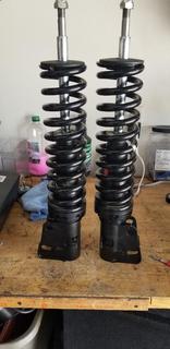

I recently made my own. I purchased KYB shocks and struts from RockAuto for an effective cost of $25 per corner. Found Ford Mustang Cobra 12" 325LBS coils on OfferUp for $30 and pick up a 1990 Honda Civic Coilover Kit for another $20 on OfferUp (for the sleeves). New coilovers for under $150.
Instructions can be found on the forum. Maybe you want to go this route.
