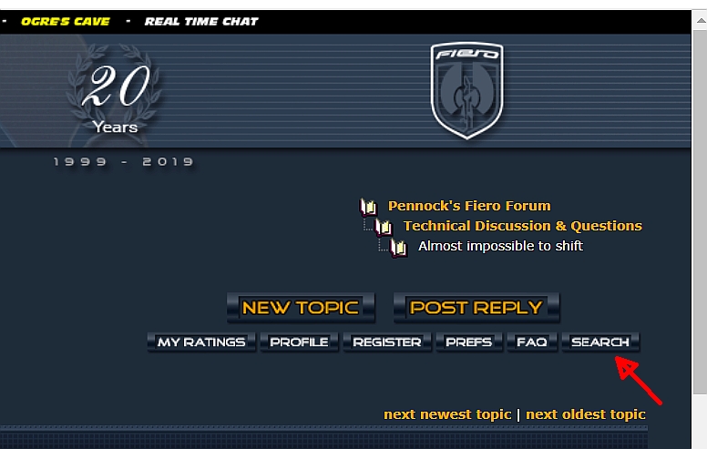

My apologies, this site is honestly hard to navigate, I looked for a search bar to search for this topic.

Achimasi
OCT 12, 03:27 PM
Yeah I found it shortly after I read your reply. Found a few posts that was kind of similar but not close enough. I'll try the bleeding idea. Thanks.
This site layout is still really weird. Lol
