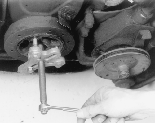

Patrick OCT 07, 02:24 PM
Originally posted by ttt123:
Only vid or help i seen on youtube was two pry bars...
Found this image online which is similar to the type of puller I use/have.
