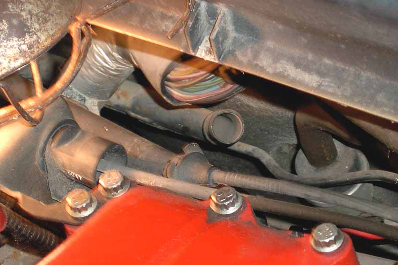

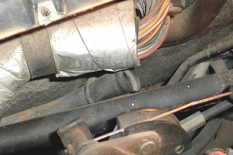

Quick question here -- Can anyone tell me what exactly this pipe is, the purpose of it and if it's supposed to be open-ended like this? I've been having idling issues lately and thought maybe this was the culprit. It's located near the firewall.
Thank you

Thanks Gall - I wasn't aware this was part of the recall. It has been like this for the longest time but I assume the PO had this done. I am assuming it can be left as/is at this point then. [This message has been edited by Brent7088 (edited 10-02-2019).]
OCT 02, 12:50 PM
quote | Originally posted by Brent7088:
From This thread...
Hopefully that pipe was disconnected from your air filter canister during the recall (and the canister hole plugged), otherwise that uncapped pipe has been allowing outside unfiltered air to enter into the filtered side of your air intake system all these years.

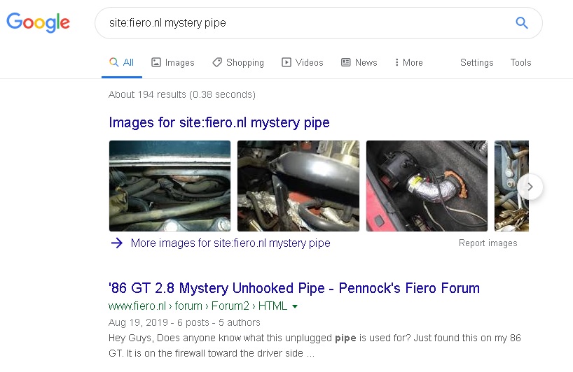

quote | Originally posted by Brent7088: I had no idea how to search for it in the archived questions. |
I use google to find my stuff, not the PFF internal search engine.
I use the term "site:fiero.nl" in google when I want to find something on here.
