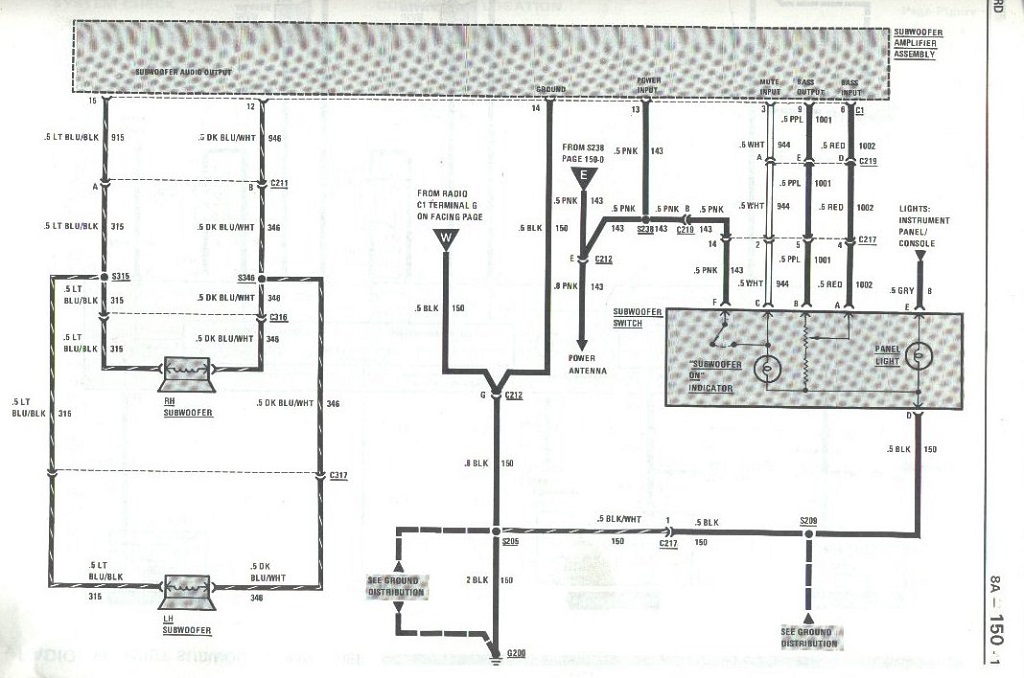

Is a UQ7 amp from an 88 Firebird Trans Am compatible with a stock Fiero performance sound system?

hercimer01 SEP 20, 11:14 PM
Since I haven't found any threads I figured I would make one.
The UQ6 Fiero Amp PN 16040752.
The UQ7 Firebird Amp PN 16040742.
The UQ7 difference is that it drives 2, 10 ohm woofers (5 ohms total) in parallel. The stock Fiero Sub Woofer is 4 ohms. All the connections are the same otherwise.
It did seem like the UQ7 hit harder when I ran it in my car.
