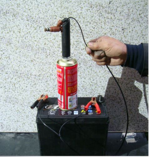

You can purchase an off the car inexpensive injector cleaning kit (about $20) that works with a can of carburetor cleaner. It will also show if the injector is clogged or spraying.
I usually clean the injectors while on the car with a more elaborate pressurized system but this simple cleaner/tester will work fine.
