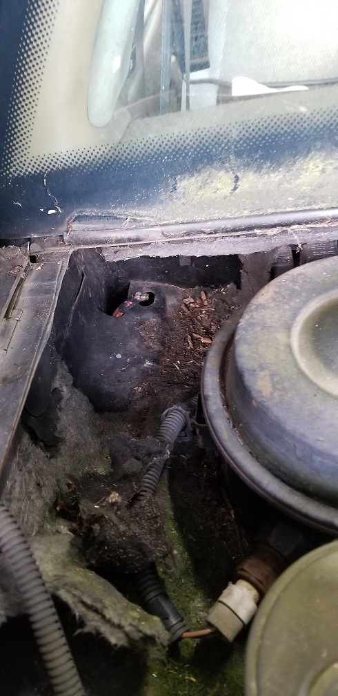

Well this is my first post in about 3 years so bare with me lol. So a couple days ago, I bought my first Fiero back (happened to be my first car). I haven't seen it in 15 years and the guy who had it after me was who I bought it back from. Anyway, the car sat for about the last 5 years. I have gone through the car top to bottom and it still only has 80K on the clock and no rust to be found. I do however have a harness near the air filter housing that seems to be cut/ damaged and I have no clue what its for as I cannot find the other end. I have no check engine lights of any kind so that's no help. Any thoughts? Also, I have a strange smell. Its like a mouse nest smell but it only is noticeable when standing outside the car, with the decklid open when the car is running. No smells inside at anytime whatsoever. Any ideas? Thanks guys!

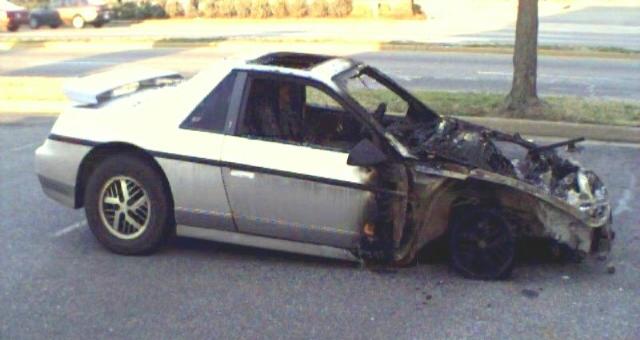

For sure! And check it now before your car catches fire. Seriously.
Don't turn your AC/heater fan on until you've checked/cleaned out the enclosure. Read This thread.[This message has been edited by Patrick (edited 09-11-2019).]

Wires thru "firewall" there above isn't stock. All Stock wiring comes thru 2 bungs in center of that wall above ECM. Likely need to look behind or pull D side seat to look for other end and what goes to.
Pull iffy wiring out and plug the hole. metal glued over the hole.
Mice can cause many problems even fires as said above. Pull the blower to actually look inside ac/heater box. Not just pull the resistors. Example: http://www.fiero.nl/forum/Forum2/HTML/141959.html
