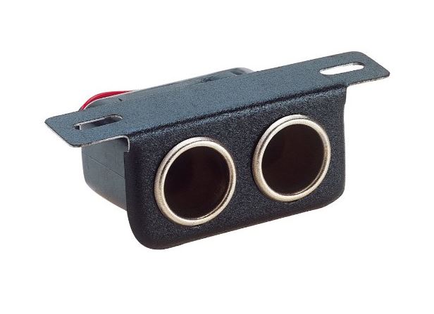

Mounting one of these under dash units saves drilling holes in dash.
https://www.amazon.com/Cust...-Mount/dp/B01ACD3FS8
https://www.amazon.com/Cust...ptacle/dp/B009IK94FA

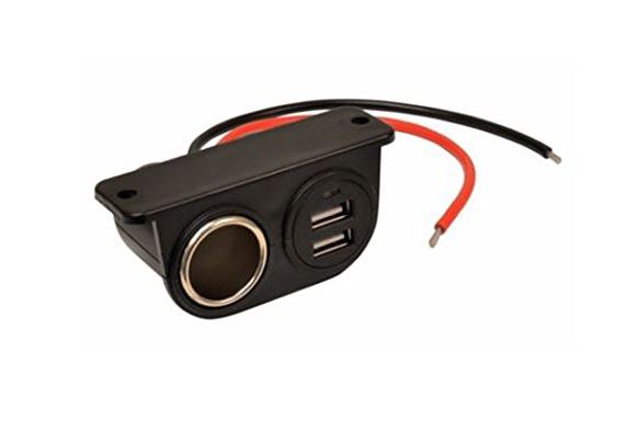

Tony Kania SEP 04, 05:11 PM
Like above, I used one similar with two USBs and one 12v socket. I have it under the left side of the dash just poking out. I wired it with a 15 amp fuse to an open fuse slot in the fuse box.

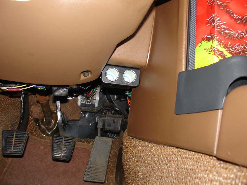

hnthomps SEP 04, 08:54 PM
Like the second photo above, I installed one of these power outlets on the passenger side of my F355 dash and it worked out well.

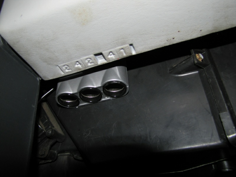

Saw a couple of pics of what others have done with 12v power sockets...
Passenger side
Driver's side
